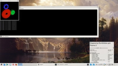

Вот только по самой работе двойной графики вопросы есть. "Что я делаю не так?"
Запускаю без дополнительных команд.
glxgears
Running synchronized to the vertical refresh. The framerate should be
approximately the same as the monitor refresh rate.
302 frames in 5.0 seconds = 60.366 FPS
301 frames in 5.0 seconds = 60.022 FPS
301 frames in 5.0 seconds = 60.017 FPS
301 frames in 5.0 seconds = 60.021 FPS
301 frames in 5.0 seconds = 60.018 FPS
301 frames in 5.0 seconds = 60.020 FPS
301 frames in 5.0 seconds = 60.019 FPS
300 frames in 5.0 seconds = 59.822 FPS
301 frames in 5.0 seconds = 60.024 FPS
XIO: fatal IO error 11 (Resource temporarily unavailable) on X server ":0"
after 12888 requests (12888 known processed) with 0 events remaining.Код: Выделить всё
primusrun glxgears
292 frames in 5.0 seconds = 58.317 FPS
301 frames in 5.0 seconds = 60.025 FPS
301 frames in 5.0 seconds = 60.016 FPS
300 frames in 5.0 seconds = 59.820 FPS
301 frames in 5.0 seconds = 59.998 FPS
300 frames in 5.0 seconds = 59.841 FPS
X Error of failed request: BadDrawable (invalid Pixmap or Window parameter)
Major opcode of failed request: 154 (DRI2)
Minor opcode of failed request: 7 (DRI2GetBuffersWithFormat )
Resource id in failed request: 0x3c00002
Serial number of failed request: 12422
Current serial number in output stream: 12422
primus: warning: dropping a frame to avoid deadlock
primus: warning: timeout waiting for display worker
after 31 requests (31 known processed) with 0 events remaining.
belykh@notebook ~ $ optКод: Выделить всё
optirun glxgears
4329 frames in 5.0 seconds = 865.648 FPS
4394 frames in 5.0 seconds = 878.644 FPS
4450 frames in 5.0 seconds = 889.828 FPS
4397 frames in 5.0 seconds = 879.231 FPS
4241 frames in 5.0 seconds = 848.058 FPS
4306 frames in 5.0 seconds = 861.170 FPS
4412 frames in 5.0 seconds = 882.298 FPS
3460 frames in 5.0 seconds = 691.802 FPS
[VGL] ERROR: in readback--
[VGL] 241: Window has been deleted by window manager
Однако, если растянуть окно glgears на весь экран. то разницы в FPS практически не будет.

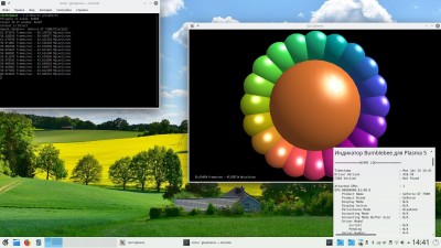

Настроил видео.
Установились дрова nvidia410.
Установил plasma5-applet-bumblebee-indicator.
Как починил его в марте, так ничего не изменилось
Как работало, так и работает.
И правильно определяет каталоги, где искать файл nvidia-smi.
Приложу картинку.
