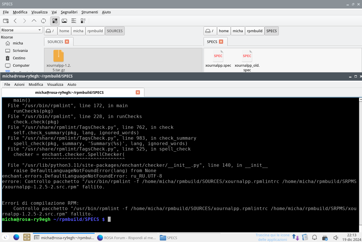

Ciao
Che tipo di errore è questo?
Sto cercando aggiornando il software Xournal++ (https://xournalpp.github.io/) creandone il pacchetto RPM ma alla fine quando viene lanciato il comando rpmlint per le verifiche mi viene restituito questo errore. Bug di rpmlint/enchant/python&C. oppure cosa?
NOTA: In Rosa2021.1 il pacchetto rpm viene creato senza alcun problema.
Hi,
What kind of error is this?
I am trying to update the Xournal++ (https://xournalpp.github.io/) software by creating the RPM package but at the end when the rpmlint command is run for verification I get this error.
rpmlint/enchant/python&C. bug or what?
NOTE: In Rosa2021.1 rpm package is created without any problem.

What is the output of the
python3 -m locale
command on your computer?

Твою ошибку воспроизвести мне не удалось. Про мою ошибку. Она появлялась, когда я LIVE загружал на русском, и, следовательно, приходилось удалять строку в spec. Когда загружался на итальянском, то rpm собиралось без ошибок (не удалял строку).
I couldn't reproduce your mistake. About my mistake. It appeared when I downloaded LIVE in Russian, and therefore I had to delete the line in spec. When it was loaded in Italian, the rpm was assembled without errors (did not delete the line).

Try to install universal-ru-dict-hunspell package.
MikiLinux
Сообщения: 186
Operating system: Rosa13
Откуда: Vicino Roma
Errore verifica rpm/RPM checked error
Сообщение MikiLinux »
termim писал(а): 20 дек 2024, 04:01 Try to install universal-ru-dict-hunspell package.
:Yahoo!:
Grazie mille!/Большое спасибо!
