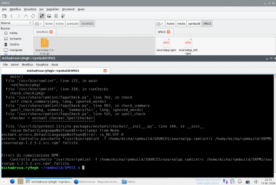

Che tipo di errore è questo?
Sto cercando aggiornando il software Xournal++ (https://xournalpp.github.io/) creandone il pacchetto RPM ma alla fine quando viene lanciato il comando rpmlint per le verifiche mi viene restituito questo errore. Bug di rpmlint/enchant/python&C. oppure cosa?
NOTA: In Rosa2021.1 il pacchetto rpm viene creato senza alcun problema.
Hi,
What kind of error is this?
I am trying to update the Xournal++ (https://xournalpp.github.io/) software by creating the RPM package but at the end when the rpmlint command is run for verification I get this error.
rpmlint/enchant/python&C. bug or what?
NOTE: In Rosa2021.1 rpm package is created without any problem.

Подробней. Я скачал образ ROSA13 и делал в LIVE. У меня ошибка была другая (смотри скрин). После удаления строки всё собралось. Пакеты полученные в архиве https://disk.yandex.ru/d/GMnFAoyj3ToMkw
More details. I downloaded the ROSA13 image and did it LIVE. I had another mistake (see the screenshot). After deleting the line, everything was assembled. Packages received in the archive https://disk.yandex.ru/d/GMnFAoyj3ToMkw

Твою ошибку воспроизвести мне не удалось. Про мою ошибку. Она появлялась, когда я LIVE загружал на русском, и, следовательно, приходилось удалять строку в spec. Когда загружался на итальянском, то rpm собиралось без ошибок (не удалял строку).
I couldn't reproduce your mistake. About my mistake. It appeared when I downloaded LIVE in Russian, and therefore I had to delete the line in spec. When it was loaded in Italian, the rpm was assembled without errors (did not delete the line).

Try to install universal-ru-dict-hunspell package.
