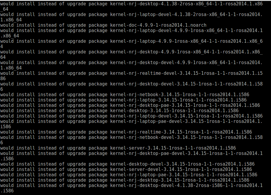

I am using HP DV6 Notebook with Rosa Linux 4.1.34-nrj-desktop-2rosa-x86_64 #1 SMP PREEMPT
After the last update to 4.1.34 the system does not update, it always freezes when starting the update process after displaying the update window as in the attached screen shot and even when trying to install or remove software. The update process can not be stopped or killed even with kill command.

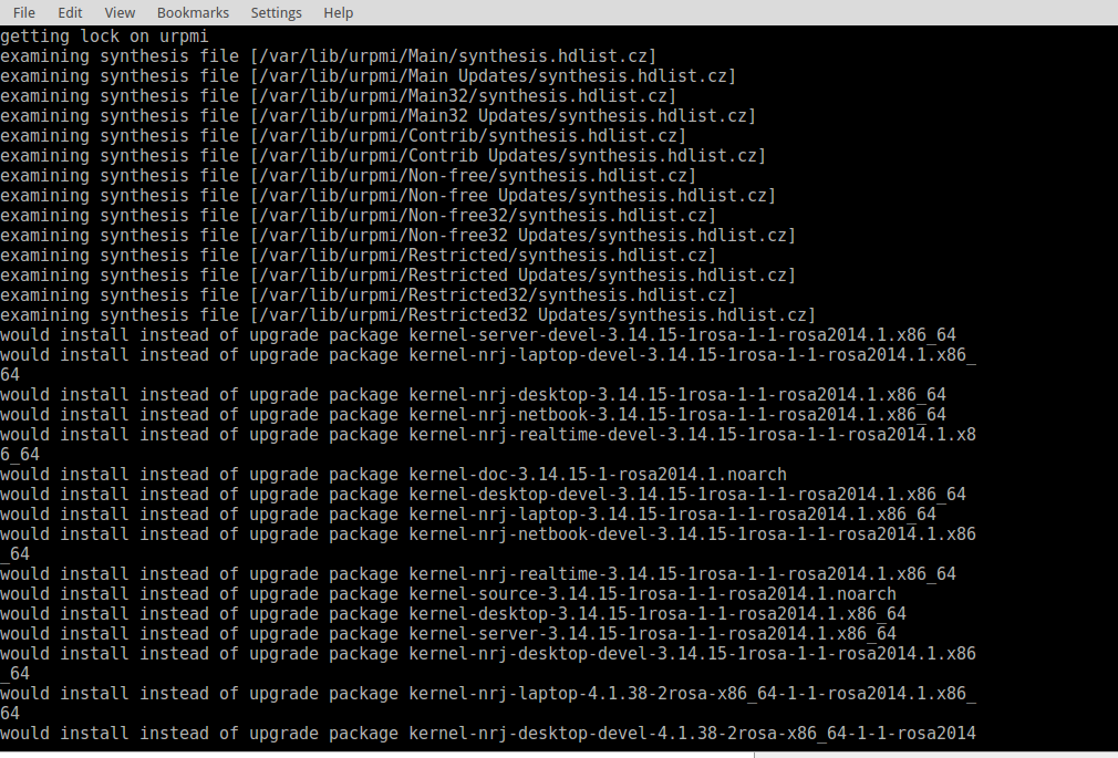

I would try to launch rpmdrake from Konsole and read there the errors that are generated

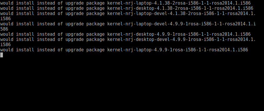

Attached is an image after running rpmdrake and it also started the software management application which froze as before.
