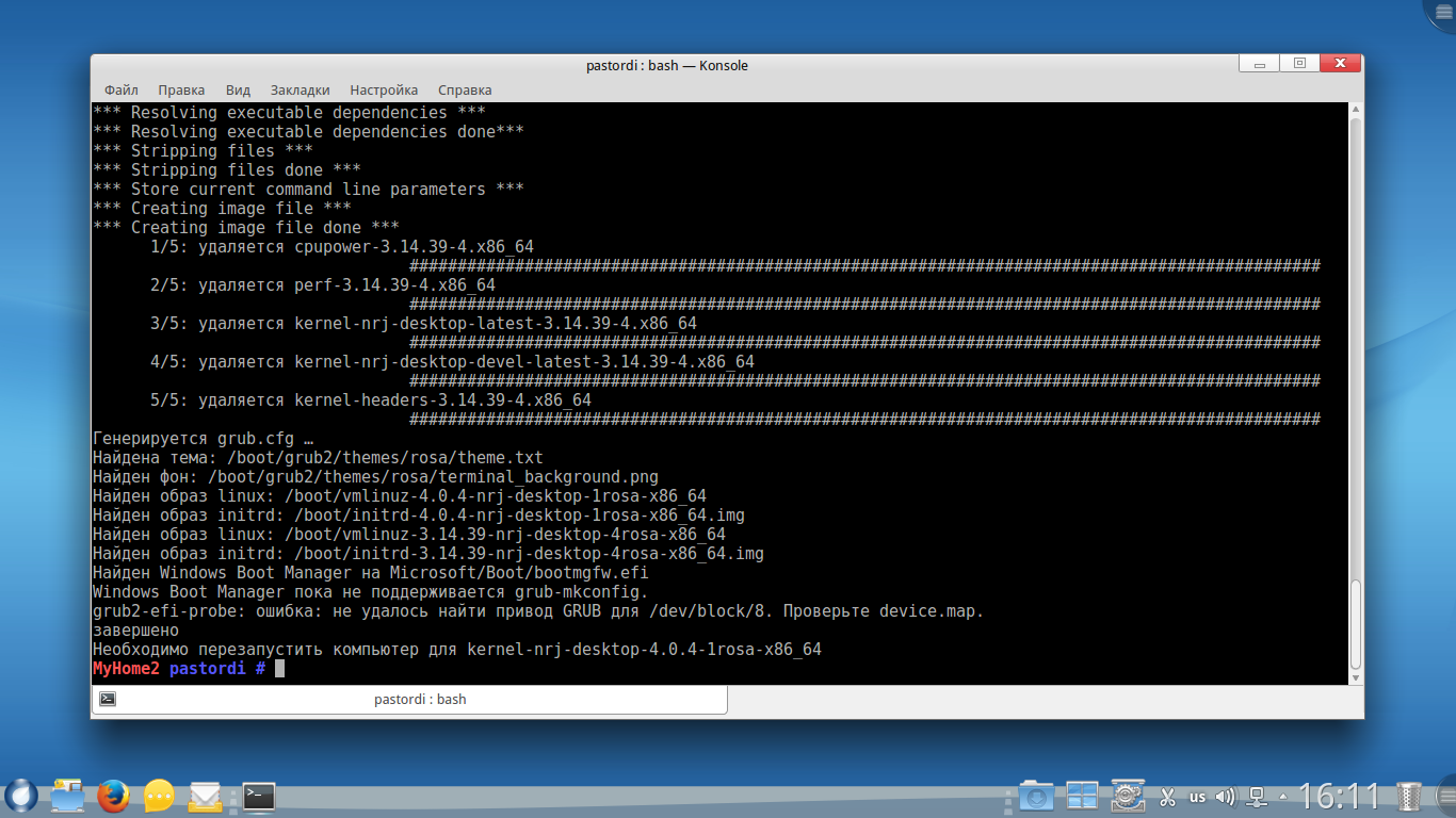

Моя вторая проба - ноут, на ядре 4.0.4 , но без Broadcom (нету драйвера, где взять?): http://hw.rosalinux.ru/index.php?probe=d148a20413
Еще при обновлении Граб что-то ругнулся. Но перезагрузился вроде нормально.
После перезагрузки. Вывод syslog, на скрине ниже: верхняя часть - вывод ядра 3.14.39, нижняя часть - вывод ядра 4.0.4
(есть различия)
В текстовом виде:
Jun  2 16:03:06 MyHome2 kernel: [    0.409652] acpi PNP0A08:00: _OSC failed (AE_ERROR); disabling ASPM
Jun  2 16:03:06 MyHome2 kernel: [    3.784072] [drm] failed to retrieve link info, disabling eDP
Jun  2 16:03:06 MyHome2 kernel: [    9.938621] ACPI: \_SB_.PCI0.PEG0.PEGP: failed to evaluate _DSM
Jun  2 16:03:06 MyHome2 kernel: [   15.879228] acer_wmi: Enabling Launch Manager failed: 0xe2 - 0x0
Jun  2 16:03:09 MyHome2 sensord: Error getting sensor data: nouveau/#0: Can't read
Jun  2 16:03:09 MyHome2 sensord: sensor read error (-1)
Jun  2 16:03:16 MyHome2 kernel: [   32.882135] ACPI: \_SB_.PCI0.PEG0.PEGP: failed to evaluate _DSM
Jun  2 16:03:23 MyHome2 systemd[5217]: Failed to open private bus connection: Failed to connect to socket /run/user/500/dbus/user_bus_socket: No such file or directory
Jun  2 16:12:29 MyHome2 systemd[1]: Failed to open private bus connection: Failed to connect to socket /var/run/dbus/system_bus_socket: No such file or directory
Jun  2 16:12:29 MyHome2 kernel: [    0.342248] acpi PNP0A08:00: _OSC failed (AE_ERROR); disabling ASPM
Jun  2 16:12:29 MyHome2 kernel: [    0.498805] pci 0000:01:00.0: BAR 6: failed to assign [mem size 0x00080000 pref]
Jun  2 16:12:29 MyHome2 kernel: [    2.810949] [drm] failed to retrieve link info, disabling eDP
Jun  2 16:12:29 MyHome2 kernel: [    7.962515] ACPI: \_SB_.PCI0.PEG0.PEGP: failed to evaluate _DSM
Jun  2 16:12:29 MyHome2 kernel: [   11.877426] acer_wmi: Enabling Launch Manager failed: 0xe2 - 0x0
Jun  2 16:12:49 MyHome2 systemd[1]: Failed to read PID from file /run/openl2tpd.pid: Invalid argument
Jun  2 16:12:56 MyHome2 kernel: [   47.008967] ACPI: \_SB_.PCI0.PEG0.PEGP: failed to evaluate _DSM
Jun  2 16:12:58 MyHome2 systemd[6225]: Failed to open private bus connection: Failed to connect to socket /run/user/500/dbus/user_

Generating grub.cfg ...
Found theme: /boot/grub2/themes/rosa/theme.txt
Found background: /boot/grub2/themes/rosa/terminal_background.png
Found linux image: /boot/vmlinuz-4.0.4-nrj-desktop-1rosa-x86_64
Found initrd image: /boot/initrd-4.0.4-nrj-desktop-1rosa-x86_64.img
Found linux image: /boot/vmlinuz-3.14.39-nrj-desktop-4rosa-x86_64
Found initrd image: /boot/initrd-3.14.39-nrj-desktop-4rosa-x86_64.img
Found Windows Boot Manager on Microsoft/Boot/bootmgfw.efi
Windows Boot Manager is not yet supported by grub-mkconfig.
grub2-efi-probe: error: cannot find a GRUB drive for /dev/block/8.  Check your device.map.
done

You should restart your computer for kernel-nrj-desktop-4.0.4-1rosa-x86_64
MyHome2 ~ #
(После перезагрузки, как-то... само wl встал, долго загружалось)
Steps
  • Add repo kernel 4.0.4
  • Add repo broadcom-wl for 4.0.4
  • urpmi --auto-update
Expected
  • Kernel and Broadcom-wl is installed
Actual
  • During installation broadcom-wl not installed, but kernel is installed
  • After reboot broadcom-wl is auto installed. (Boot time was 2min)

PastorDi писал(а):Похоже, что если обновлять вместе и ядро и wl то не ставится wl. А если последовательно, сначало ядро, потом wl, то wl ставится.
Тут, похоже, было так. Сначала поставился devel-пакет для нового ядра - и пересобирались те DKMS-пакеты, которые были на тот момент. Нового broadcom-wl ещё не было, только старый.
Когда ставится broadcom-wl, он ставится для тех ядер, которые в системе уже установлены. Установлено на тот момент было 3.14.39-4. Судя по логу, под него broadcom-wl поставился нормально.
После этого стало ставиться ядро 4.0.4. Почему при этом не пересобрался новый broadcom-wl - хороший вопрос, я разберусь. Правил уже такие вещи в других пакетах.
Ну, а поскольку не пересобрался так, то пересобрался при след. загрузке, оттого она и была долгой.

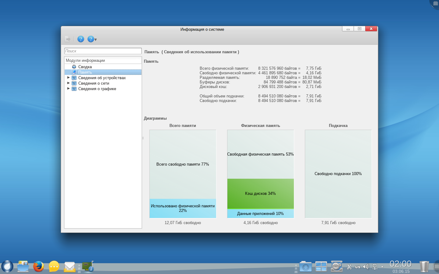

Что-то у меня в Kinfocenter постепенно растет "Дисковый кэш" на обеих компах. На стационарнике, еще пофигу, там мозгов много, а на ноуте 4Гб и дисковый кэш аж под 3Гб занимает. Специально слежу чтобы оба компа НЕ уходили в гибернацию.
Интересно, что понимается под "Дисковым кэшем" в Kinfocenter?
Подозрительно все это, никогда такого не наблюдал. На обеих компах ядро 4.0.4
Вот скрин с стационарника:

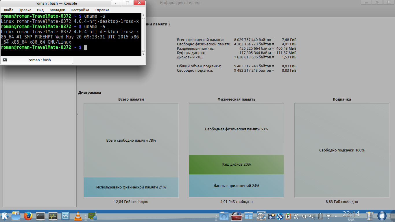

Re: Где взять другое ядро
А сколько надо кэша? Сколько было на старом ядре? У меня на старом ядре
,на SSD. При этом работает только firefox. А у вас, наверно, больше программ включено.
Сообщения: 2678
На старом ядре что-то я не обращал внимания на это.
Не, программ не много запущено, Долфин + Файрфокс.
Мне просто интересно, это нормальное "явление" или нет?
Поставил новое ядро. После загрузки кэш был 15% - после часа работы:
То есть пока примерно равна показателю на старом ядре - значительных отклонений не наблюдаю.
При этом у нас разная ситуация - у меня ноут работает не постоянно, а у вас, как я понял по долгу.
Вам нужно смотреть показатели старого ядра, чтобы сравнить...
