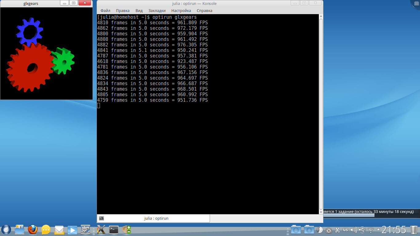

Сообщения: 7814
Re: activer Nvidia optimus avec blumbebee
I will try more.
Install Nvidia driver through XFdrake.
After installation of drivers we stop setup without saving.
You must stop setting.
You can not create file xorg.conf.
You just need to close XFdrake, everywhere pressing Cancel.
Next, remove the driver nouveau, running the console as root "rpm -e --nodeps x11-driver-video-nouveau".
Then we set bumblebee packet.
Then we edit / etc/bumblebee/bumblebee.conf
We make changes
TurnCardOffAtExit=true
Driver=nvidia
KernelDriver=nvidia-current
It shall be such
# Configuration file for Bumblebee. Values should **not** be put between quotes
## Server options. Any change made in this section will need a server restart
# to take effect.
[bumblebeed]
# The secondary Xorg server DISPLAY number
VirtualDisplay=:8
# Should the unused Xorg server be kept running? Set this to true if waiting
# for X to be ready is too long and don't need power management at all.
KeepUnusedXServer=false
# The name of the Bumbleblee server group name (GID name)
ServerGroup=bumblebee
# Card power state at exit. Set to false if the card shoud be ON when Bumblebee
# server exits.
# The default behavior of '-f' option on optirun. If set to "true", '-f' will
# be ignored.
NoEcoModeOverride=false
# The Driver used by Bumblebee server. If this value is not set (or empty),
# auto-detection is performed. The available drivers are nvidia and nouveau
# (See also the driver-specific sections below)
Driver=nvidia
## Client options. Will take effect on the next optirun executed.
[optirun]
# The method used for VirtualGL to transport frames between X servers.
# Possible values are proxy, jpeg, rgb, xv and yuv.
VGLTransport=proxy
# Should the program run under optirun even if Bumblebee server or nvidia card
# is not available?
AllowFallbackToIGC=false
# Driver-specific settings are grouped under [driver-NAME]. The sections are
# parsed if the Driver setting in [bumblebeed] is set to NAME (or if auto-
# detection resolves to NAME).
# PMMethod: method to use for saving power by disabling the nvidia card, valid
# values are: auto - automatically detect which PM method to use
#         bbswitch - new in BB 3, recommended if available
#       switcheroo - vga_switcheroo method, use at your own risk
#             none - disable PM completely
# https://github.com/Bumblebee-Project/Bumblebee/wiki/Comparison-of-PM-methods
## Section with nvidia driver specific options, only parsed if Driver=nvidia
[driver-nvidia]
# Module name to load, defaults to Driver if empty or unset
Module=nvidia
PMMethod=auto
# colon-separated path to the nvidia libraries
LibraryPath=/usr/lib/nvidia-current:/usr/lib64/nvidia-current
# comma-separated path of the directory containing nvidia_drv.so and the
# default Xorg modules path
XorgModulePath=/usr/lib/nvidia-current/xorg,/usr/lib64/nvidia-current/xorg,/usr/lib/xorg/modules,/usr/lib64/xorg/modules,/usr/lib/xorg/extra-modules,/usr/xorg/extra-modules
XorgConfFile=/etc/bumblebee/xorg.conf.nvidia
## Section with nouveau driver specific options, only parsed if Driver=nouveau
[driver-nouveau]
KernelDriver=nouveau
PMMethod=auto
XorgConfFile=/etc/bumblebee/xorg.conf.nouveau
Then to file/etc/modprobe.conf we write
nvidia-current && bumblebee
Now it is possible to reboot.
After loading we check "optirun glxgears"
