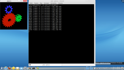

- Сообщения: 8233
Re: activer Nvidia optimus avec blumbebee
I will try more.
Install Nvidia driver through XFdrake.
After installation of drivers we stop setup without saving.
You must stop setting.
You can not create file xorg.conf.
You just need to close XFdrake, everywhere pressing Cancel.
Next, remove the driver nouveau, running the console as root "rpm -e --nodeps x11-driver-video-nouveau".
Then we set bumblebee packet.
Then we edit / etc/bumblebee/bumblebee.conf
We make changes
It shall be such
Then to file/etc/modprobe.conf we write
Now it is possible to reboot.
After loading we check "optirun glxgears"
We make changes
TurnCardOffAtExit=true
Driver=nvidia
KernelDriver=nvidia-currentКод: Выделить всё

nvidia-current && bumblebeeAfter loading we check "optirun glxgears"

Valerio94r
- Сообщения: 4
- Зарегистрирован: 03 янв 2014, 18:20
Re: [RESOLU]activer Nvidia optimus avec blumbebee
J'ai suivi tout l'entraînement et après vous avez fait tout et exécutez la commande "glxgears optirun" Je reçois ce résultat:
[98.235790] [ERROR]The Bumblebee daemon has not been started yet or the socket path /var/run/bumblebee.socket was incorrect.
[98.235822] [ERROR]Could not connect to bumblebee daemon - is it running?
Valerio94r
- Сообщения: 4
After installation of drivers we stop setup without saving. You must stop setting.
We make changes
It shall be such
Reboot.
J'ai changé bumbleebee avec le "bumblebeed" et maintenant j'ai cette erreur:
Comment puis-je corriger ces erreurs?
We make changes
Driver=nvidia
# Configuration file for Bumblebee. Values should **not** be put between quotes
## Server options. Any change made in this section will need a server restart
# to take effect.
[bumblebeed]
# The secondary Xorg server DISPLAY number
VirtualDisplay=:8
# Should the unused Xorg server be kept running? Set this to true if waiting
# for X to be ready is too long and don't need power management at all.
KeepUnusedXServer=false
# The name of the Bumbleblee server group name (GID name)
ServerGroup=bumblebee
# Card power state at exit. Set to false if the card shoud be ON when Bumblebee
# server exits.
# The default behavior of '-f' option on optirun. If set to "true", '-f' will
# be ignored.
NoEcoModeOverride=false
# The Driver used by Bumblebee server. If this value is not set (or empty),
# auto-detection is performed. The available drivers are nvidia and nouveau
# (See also the driver-specific sections below)
Driver=nvidia
# Directory with a dummy config file to pass as a -configdir to secondary X
XorgConfDir=/etc/bumblebee/xorg.conf.d
## Client options. Will take effect on the next optirun executed.
[optirun]
# Acceleration/ rendering bridge, possible values are auto, virtualgl and
# primus.
Bridge=auto
# The method used for VirtualGL to transport frames between X servers.
# Possible values are proxy, jpeg, rgb, xv and yuv.
VGLTransport=proxy
# List of paths which are searched for the primus libGL.so.1 when using
# the primus bridge
PrimusLibraryPath=/usr/lib/primus:/usr/lib32/primus
# Should the program run under optirun even if Bumblebee server or nvidia card
# is not available?
AllowFallbackToIGC=false
# Driver-specific settings are grouped under [driver-NAME]. The sections are
# parsed if the Driver setting in [bumblebeed] is set to NAME (or if auto-
# detection resolves to NAME).
# PMMethod: method to use for saving power by disabling the nvidia card, valid
# values are: auto - automatically detect which PM method to use
# bbswitch - new in BB 3, recommended if available
# switcheroo - vga_switcheroo method, use at your own risk
# none - disable PM completely
# https://github.com/Bumblebee-Project/Bumblebee/wiki/Comparison-of-PM-methods
## Section with nvidia driver specific options, only parsed if Driver=nvidia
[driver-nvidia]
# Module name to load, defaults to Driver if empty or unset
module=nvidia
PMMethod=auto
# colon-separated path to the nvidia libraries
LibraryPath=/usr/lib/nvidia-current:/usr/lib64/nvidia-current
# comma-separated path of the directory containing nvidia_drv.so and the
# default Xorg modules path
XorgModulePath=/usr/lib/nvidia-current/xorg,/usr/lib64/nvidia-current/xorg,/usr/lib/xorg/modules,/usr/lib64/xorg/modules,/usr/lib/xorg/extra-modules,/usr/xorg/extra-modules
XorgConfFile=/etc/bumblebee/xorg.conf.nvidia
## Section with nouveau driver specific options, only parsed if Driver=nouveau
[driver-nouveau]
KernelDriver=nouveau
PMMethod=auto
XorgConfFile=/etc/bumblebee/xorg.conf.nouveauКод: Выделить всё
nvidia-current && bumblebeeJ'ai changé bumbleebee avec le "bumblebeed" et maintenant j'ai cette erreur:
[valerio@Valerio-N550JV ~]$ optirun glxgears
[596.910916] [ERROR]The Bumblebee daemon has not been started yet or the socket path /var/run/bumblebee.socket was incorrect.
[596.910939] [ERROR]Could not connect to bumblebee daemon - is it running?Код: Выделить всё
[valerio@Valerio-N550JV ~]$ glxgears
Xlib: extension "GLX" missing on display ":0".
Error: couldn't get an RGB, Double-buffered visualКод: Выделить всё
[root@Valerio-N550JV valerio]# modprobe nvidia
libkmod: kmod_config_parse: /etc/modprobe.d/01_mandriva.conf line 1: ignoring bad line starting with 'nvidia-current'
modprobe: FATAL: Module nvidia-current not found.
modprobe: ERROR: Error running install command for nvidia
modprobe: ERROR: could not insert 'nvidia': Operation not permitted
[valerio@Valerio-N550JV ~]$ lspci -k | grep -A 2 -i "VGA"
00:02.0 VGA compatible controller: Intel Corporation 4th Gen Core Processor Integrated Graphics Controller (rev 06)
Subsystem: ASUSTeK Computer Inc. Device 11cd
Kernel modules: i915
