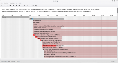

turik02 писал(а): 19 сен 2023, 23:35 6.400s (initrd) - это нормальная скорость загрузки на ssd или initrd может и быстрее?
ITALIANO
Nel mio caso (disco SSD) il kernel prende circa 3 secondi e initrd circa 4 secondi (immagine in basso).
Ho un "piccolo" SSD CRUCIALBX500 240 GB CT240BX500SSD1
Per analizzare i tempi all'avvio si può impartire il comando:
systemd-analyze plot > boot.svg
In my scenario (SSD hard disk) kernel 3s and initrd about 4s (image below).
I have a "simple" SSD CRUCIALBX500 240 GB CT240BX500SSD1
If you want to analyze boot time use this command:

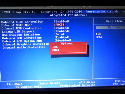

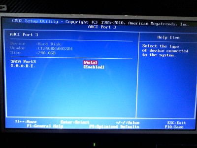

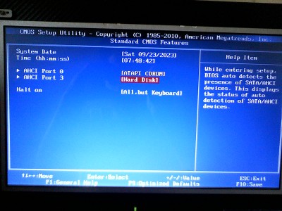

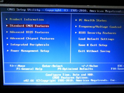

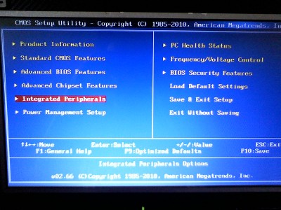

Сообщения: 857
initrd
In the BIOS, after selecting the IDE mode, I choose where to boot from. There is the word SATA in front of the disk name, when selecting the AHCI mode, there is the word IDE. Is this how it should be or is it because of the old BIOS (2010)?
MikiLinux
Сообщения: 186
Operating system: Rosa13
Откуда: Vicino Roma
initrd
Сообщение MikiLinux »
Same here: BIOS 2010 (images below).
