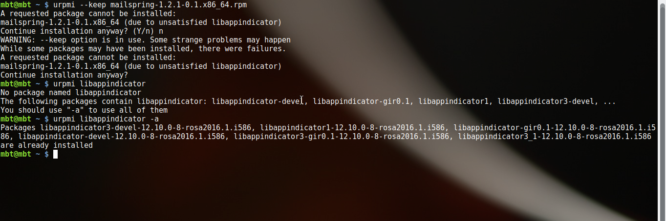

Hi all :)
I am trying to understand how to install https://getmailspring.com/ [ Mail Spring ] on ROSA Fresh.
The package is a RPM. When I try to install I get message
unsatisfied libappindicator
This is what I have tried;
mbt@mbt ~ $ urpmi --keep mailspring-1.2.1-0.1.x86_64.rpm
A requested package cannot be installed:
mailspring-1.2.1-0.1.x86_64 (due to unsatisfied libappindicator)
Continue installation anyway? (Y/n) n
WARNING: --keep option is in use. Some strange problems may happen
While some packages may have been installed, there were failures.
mbt@mbt ~ $ urpmi libappindicator
No package named libappindicator
The following packages contain libappindicator: libappindicator-devel, libappindicator-gir0.1, libappindicator1, libappindicator3-devel, ...
You should use "-a" to use all of them
mbt@mbt ~ $ urpmi libappindicator -a
Packages libappindicator3-devel-12.10.0-8-rosa2016.1.i586, libappindicator1-12.10.0-8-rosa2016.1.i586, libappindicator-gir0.1-12.10.0-8-rosa2016.1.i586, libappindicator-devel-12.10.0-8-rosa2016.1.i586, libappindicator3-gir0.1-12.10.0-8-rosa2016.1.i586, libappindicator3_1-12.10.0-8-rosa2016.1.i586 are already installed
mbt@mbt ~ $
Screen shot attached.
Can someone advise how I might be able to fix.
I have not tried to run by using Continue installation anyway? (Y/n) n
Thanks all !!!

Сообщения: 8291
Re: unsatisfied libappindicator { re: install of mailspring )
This package is only for x86_64 systems.
You can install this way.
In the folder with the package, open the console
bash-4.4$ su
Пароль:
asus Загрузки # rpm -Uvh mailspring-1.2.1-0.1.x86_64.rpm
error: Failed dependencies:
        lsb-core-noarch нужен для mailspring-1.2.1-0.1.x86_64
        libappindicator нужен для mailspring-1.2.1-0.1.x86_64
asus Загрузки # urpmi sb-core-noarch
asus Загрузки # urpmi urpmi lib64appindicator-gir0.1
asus Загрузки # rpm -Uvh --nodeps mailspring-1.2.1-0.1.x86_64.rpm
Подготовка...     ########################################### [100%]
   1:mailspring             ########################################### [100%]
asus Загрузки #
asus Загрузки # exit
exit
bash-4.4$ mailspring
shared memfd open() failed: Функция не реализована
Running database migrations
App load time: 323ms
Working.

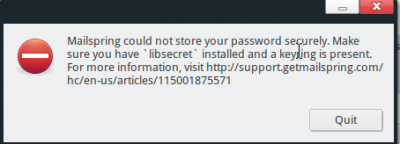

Thanks @Victor.
I followed what you said. However I have then had the following happen.
mbt mbt # rpm -Uvh --nodeps mailspring-1.2.1-0.1.x86_64.rpm
Preparing... ########################################### [100%]
mbt mbt # mailspring
XDG_RUNTIME_DIR (/run/user/500) is not owned by us (uid 0), but by uid 500! (This could e g happen if you try to connect to a non-root PulseAudio as a root user, over the native protocol. Don't do that.)
App load time: 242ms
Running Setup
{"error":null}
Manual update check (updates.getmailspring.com/check/linux/x64/1.2.1-7e7447b6/anonymous/stable) returned 204
^Z
[1]+ Stopped mailspring
mbt mbt # urpmi libsecret
No package named libsecret
The following packages contain libsecret: libsecret-devel, libsecret-gir1, libsecret-tools, libsecret1_0
mbt mbt # urpmi libsecret -a
Package Version Release Dist DEpoch Arch
(medium "Main")
libsecret-tools 0.18.5 3 rosa 2016.1 x86_64
(medium "Main32")
libsecret-devel 0.18.5 3 rosa 2016.1 i586
libsecret-gir1 0.18.5 3 rosa 2016.1 i586
libsecret1_0 0.18.5 3 rosa 2016.1 i586
1.9MB of additional disk space will be used.
225KB of packages will be retrieved.
Proceed with the installation of the 4 packages? (Y/n) y
http://mirror.rosalab.ru/rosa/rosa2016. ... x86_64.rpm
http://mirror.rosalab.ru/rosa/rosa2016. ... 1.i586.rpm
installing libsecret-gir1-0.18.5-3-rosa2016.1.i586.rpm libsecret-devel-0.18.5-3-rosa2016.1.i586.rpm libsecret-tools-0.18.5-3-rosa2016.1.x86_64.rpm libsecret1_0-0.18.5-3-rosa2016.1.i586.rpm from /var/cache/urpmi/rpms
Preparing... ##################################################################################################################
1/4: libsecret-tools ##################################################################################################################
2/4: libsecret1_0 ##################################################################################################################
3/4: libsecret-gir1 ##################################################################################################################
4/4: libsecret-devel ##################################################################################################################
App load time: 20274ms
{"error":null}
{ Error: The connection is closed message: 'The connection is closed' } { pluginIds: [] }
[1]+ Killed mailspring
mbt mbt #

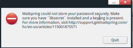

So I am unsure if it is the keyring I am missing or the wrong Libsecret .
What are your thoughts ?
Thanks !
Сообщения: 8291
Need package lib64secret1_0.
X86_64 system and libraries are usually needed lib64.
rickin
Сообщения: 34
Зарегистрирован: 06 мар 2018, 16:22
Operating system: Linux dx 4.9.76-nrj-desktop-1rosa-x86_64
Сообщение rickin »
mbt@mbt ~ $ urpmi lib64secret1_0
Package lib64secret1_0-0.18.5-3-rosa2016.1.x86_64 is already installed
Marking lib64secret1_0 as manually installed, it won't be auto-orphaned
writing /var/lib/rpm/installed-through-deps.list
mbt@mbt ~ $
Its already installed :x
