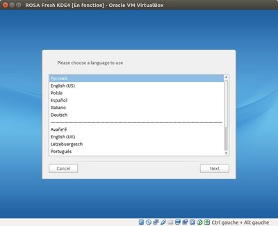

Hi,
Trying ROSA R8 KDE4 ISO image : the french is missing and the list of available languages is very short. Why ?
I've downloaded the ISO from the link given in Distrowatch
http://distrowatch.com/9498

Re: ISO ROSA R8 KDE4 missing languages
Yes, it's random build's iso bug, ABF trouble. R7 lost Poland language, R8 - France. Mea culpa
I add language control to protocol for next releases. Sorry.
For special builds (with kernel 4.4) all ok. http://mirror.yandex.ru/rosa/rosa2014.1 ... al_builds/

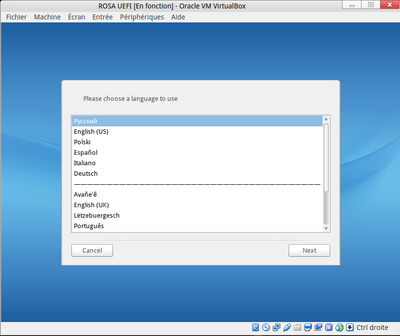

Hi keleg,
it seems there is the same problem with ISO PLASMA UEFI
Do you know if there is special builds with french language for it ?
Mon blog sur Linux : http://linuxadvantage.blogspot.com/
Thanks keleg but still no french language in thoses ISO's
