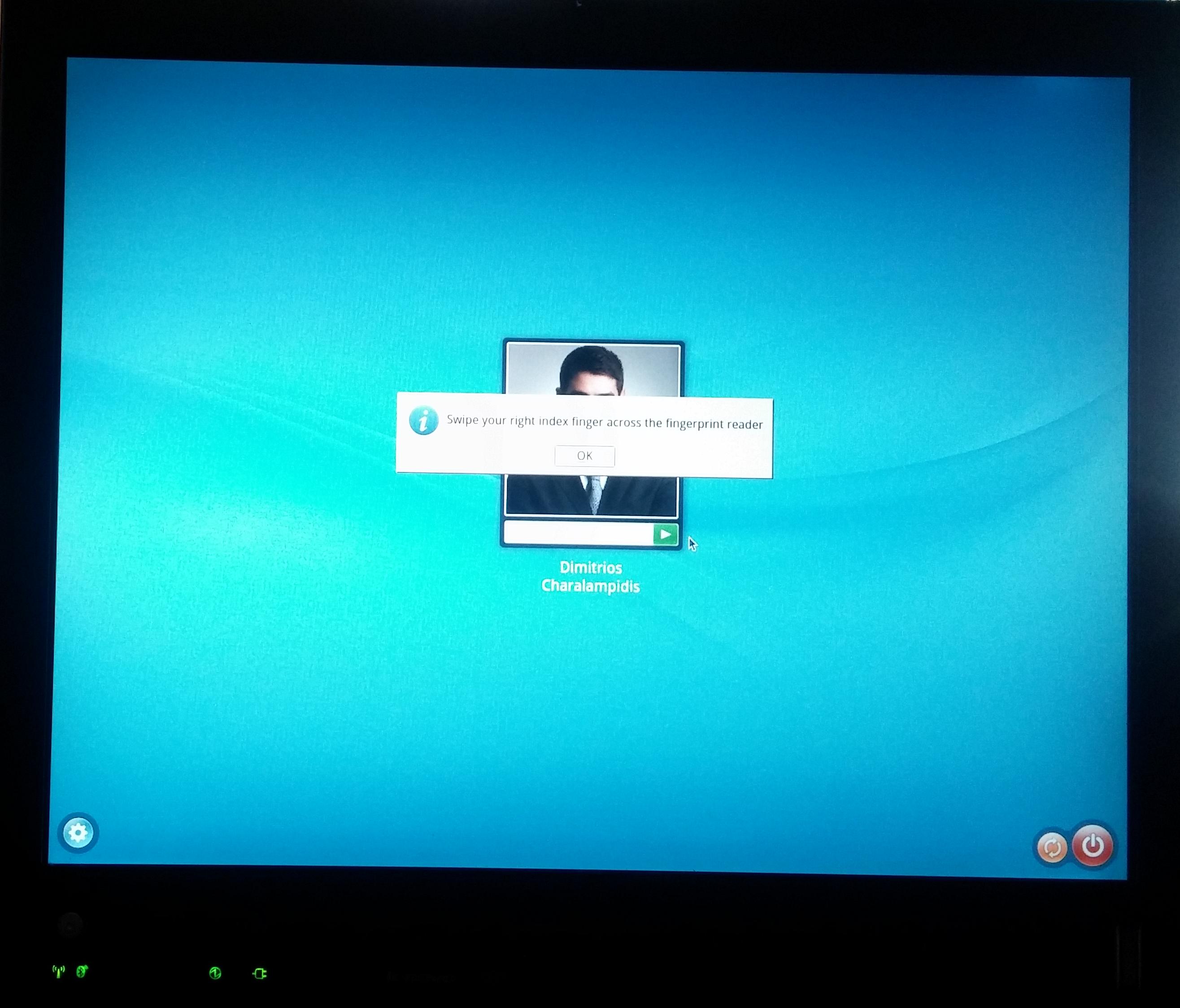

6. Fingerprint
Here is the point, where I am going to disappoint you though!
The fingerprint reader, as a device, is recognized by the kernel and if you install fprintd you can actually store your fingerprints and use them to give root permissions, but unfortunately only under Konsole, when in GUI, you are not given the option.
You can also login using your fingerprint, but the process is very ugly! You have to press enter, without entering a password at login screen (without any indication that the system is waiting for your fingerprint), an un-themed window will open, with a message asking you to swipe your finger and after you do that (without an indication on whether you have done it successfully or not), you have to click the OK button, with the mouse pointer, because the focus is not there.
This is an illustration of the above: This is what I managed to do about the fingerprint reader and I didn't like it, so I removed it and I don't use the fingerprint reader apart from the BIOS login at boot.
I don't give detailed instructions, because I didn't like it, but if somebody wants assistance with that, please don't hesitate to post a reply below.
