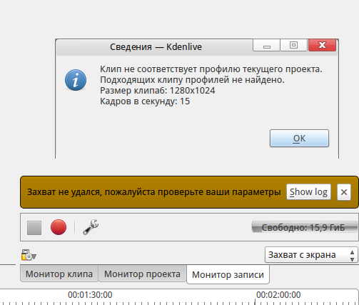

ffmpeg version 2.8.5 Copyright (c) 2000-2016 the FFmpeg developers built with gcc 4.9.2 (Linaro GCC 4.9-2014.08) 20140811 (ROSA) configuration: --prefix=/usr --enable-shared --libdir=/usr/lib --shlibdir=/usr/lib --incdir=/usr/include --disable-stripping --enable-postproc --enable-gpl --enable-pthreads --enable-ladspa --enable-libbluray --enable-libtheora --enable-libvorbis --disable-encoder=vorbis --enable-libvpx --enable-x11grab --enable-runtime-cpudetect --enable-libdc1394 --enable-libschroedinger --enable-librtmp --enable-libspeex --enable-libfreetype --enable-libnut --enable-libgsm --enable-libcelt --enable-libopencv --enable-libopenjpeg --enable-libopus --enable-libsoxr --enable-libwavpack --disable-libxavs --enable-libmodplug --enable-libass --enable-gnutls --enable-libcdio --enable-libpulse --enable-libv4l2 --enable-libmp3lame --enable-libopencore-amrnb --enable-libopencore-amrwb --enable-version3 --enable-libx264 --enable-libx265 --enable-libvo-aacenc --enable-libvo-amrwbenc --enable-libxvid libavutil 54. 31.100 / 54. 31.100 libavcodec 56. 60.100 / 56. 60.100 libavformat 56. 40.101 / 56. 40.101 libavdevice 56. 4.100 / 56. 4.100 libavfilter 5. 40.101 / 5. 40.101 libswscale 3. 1.101 / 3. 1.101 libswresample 1. 2.101 / 1. 2.101 libpostproc 53. 3.100 / 53. 3.100
Input #0, x11grab, from ':0.0+0.0': Duration: N/A, start: 1454807044.625784, bitrate: N/A Stream #0:0: Video: rawvideo (BGR[0] / 0x524742), bgr0, 1280x1024, 15 fps, 15 tbr, 1000k tbn, 15 tbc No pixel format specified, yuv444p for H.264 encoding chosen. Use -pix_fmt yuv420p for compatibility with outdated media players. [libx264 @ 0xa032060] using cpu capabilities: MMX2 SSE2 SSE3 Cache64
[libx264 @ 0xa032060] profile High 4:4:4 Predictive, level 3.2, 4:4:4 8-bit [libx264 @ 0xa032060] 264 - core 142 - H.264/MPEG-4 AVC codec - Copyleft 2003-2014 - http://www.videolan.org/x264.html - options: cabac=1 ref=2 deblock=1:0:0 analyse=0x3:0x113 me=hex subme=6 psy=1 psy_rd=1.00:0.00 mixed_ref=1 me_range=16 chroma_me=1 trellis=1 8x8dct=1 cqm=0 deadzone=21,11 fast_pskip=1 chroma_qp_offset=4 threads=3 lookahead_threads=1 sliced_threads=0 nr=0 decimate=1 interlaced=0 bluray_compat=0 constrained_intra=0 bframes=3 b_pyramid=2 b_adapt=1 b_bias=0 direct=1 weightb=1 open_gop=0 weightp=1 keyint=250 keyint_min=15 scenecut=40 intra_refresh=0 rc_lookahead=30 rc=crf mbtree=1 crf=23.0 qcomp=0.60 qpmin=0 qpmax=69 qpstep=4 ip_ratio=1.40 aq=1:1.00 Output #0, matroska, to '/home/artem/kdenlive//capture0003.mkv': Metadata: encoder : Lavf56.40.101 Stream #0:0: Video: h264 (libx264) (H264 / 0x34363248), yuv444p, 1280x1024, q=-1--1, 15 fps, 1k tbn, 15 tbc Metadata: encoder : Lavc56.60.100 libx264 Stream mapping: Stream #0:0 -> #0:0 (rawvideo (native) -> h264 (libx264)) Press [q] to stop, [?] for help
frame= 7 fps=0.0 q=0.0 size= 1kB time=00:00:00.00 bitrate=N/A
frame= 13 fps= 12 q=0.0 size= 1kB time=00:00:00.00 bitrate=N/A
frame= 17 fps= 10 q=0.0 size= 1kB time=00:00:00.00 bitrate=N/A
frame= 24 fps= 11 q=0.0 size= 1kB time=00:00:00.00 bitrate=N/A
frame= 31 fps= 11 q=0.0 size= 1kB time=00:00:00.00 bitrate=N/A
frame= 36 fps= 11 q=0.0 size= 1kB time=00:00:00.00 bitrate=N/A
frame= 39 fps=9.0 q=27.0 size= 79kB time=-00:00:00.00 bitrate=N/A
frame= 42 fps=8.4 q=27.0 size= 80kB time=00:00:00.19 bitrate=3297.0kbits/s
frame= 45 fps=7.9 q=27.0 size= 81kB time=00:00:00.39 bitrate=1663.3kbits/s
frame= 49 fps=7.5 q=27.0 size= 82kB time=00:00:00.66 bitrate=1007.6kbits/s
frame= 52 fps=7.3 q=24.0 size= 83kB time=00:00:00.86 bitrate= 787.7kbits/s
frame= 54 fps=6.9 q=27.0 size= 252kB time=00:00:00.99 bitrate=2064.5kbits/s
frame= 57 fps=6.8 q=27.0 size= 254kB time=00:00:01.19 bitrate=1734.6kbits/s

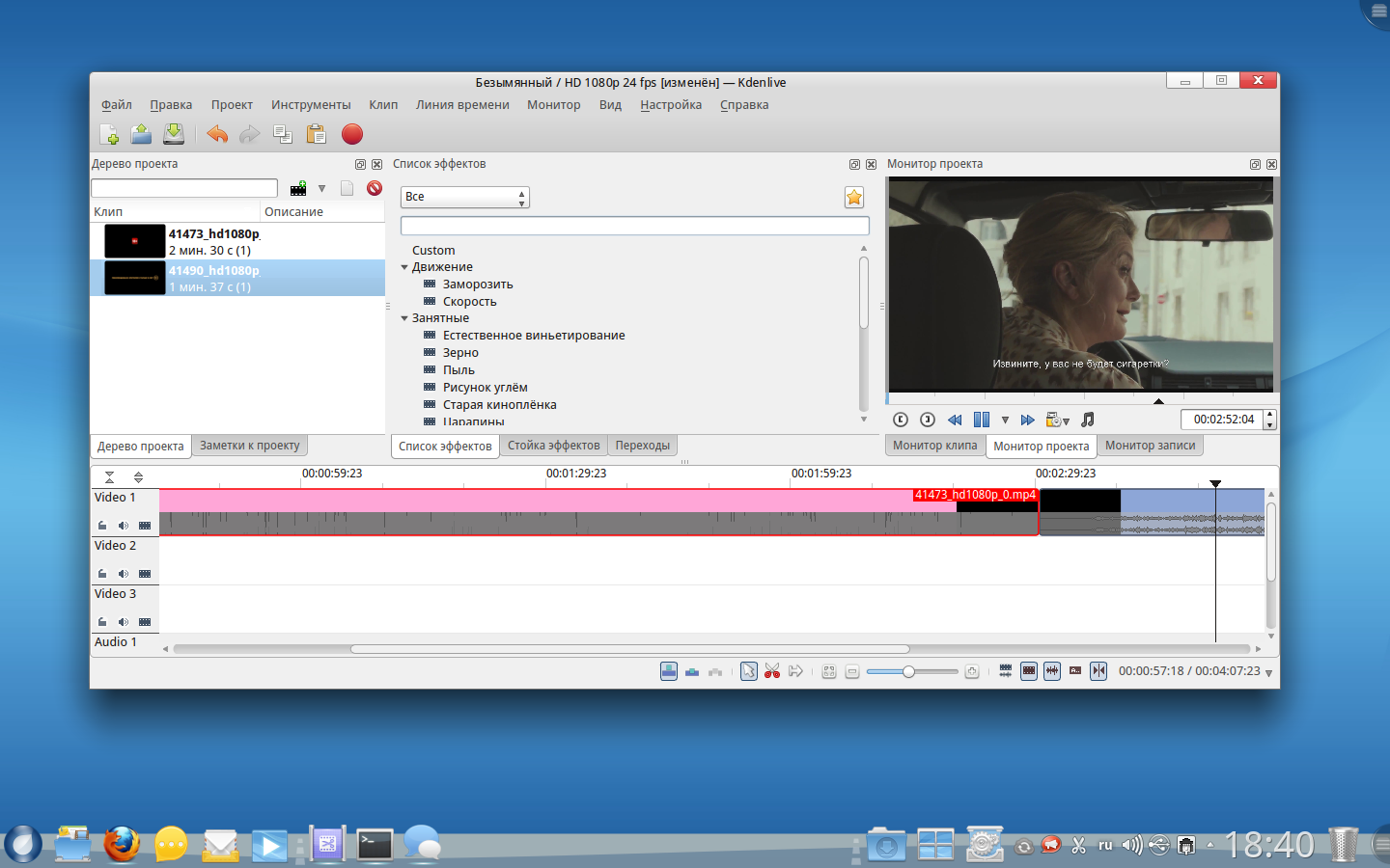

В древней версии (0.9.10): правой кнопкой по клипу в списке (дереве) клипов - Clip jobs - StabilizeOlegus22 писал(а):Подскажите, как в Kdenlive 15.04.3 стабилизировать видео? В эффектах и в контекстном меню клипа не нашёл
Пол дня гуглил, без толку. Жаль, в целом прога понравилась. Всё остальное в Linux пока не для обычного пользователя. Пришлось перезагружаться в ненавистную винду. Спасибо за попытку помочь!AVB писал(а):В древней версии (0.9.10): правой кнопкой по клипу в списке (дереве) клипов - Clip jobs - StabilizeOlegus22 писал(а):Подскажите, как в Kdenlive 15.04.3 стабилизировать видео? В эффектах и в контекстном меню клипа не нашёл
Мой склероз смутно помнит, что вроде после 0.9.10 был базар про отсутствие в новых версиях стабилизатора, который обещали вернуть.
Погуглите
