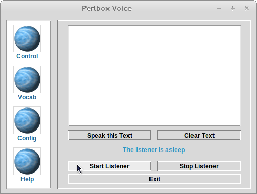

Start perlbox-voice
[daro@localhost ~]$ perlbox-voice
Using an array as a reference is deprecated at /usr/lib/perlbox-voice/Perlbox/Plugins/Desktop.pm line 69.
Using an array as a reference is deprecated at /usr/lib/perlbox-voice/Perlbox/Plugins/Desktop.pm line 73.
Festival started...
Control -> Start Listener

Hello I installed the required dependencies and + perlbox-voice on the Desktop Fresh Mate. Unfortunately, the program does not work properly.
Start perlbox-voice
daro2@localhost ~]$ perlbox-voice
Festival started...
Linux: can't open /dev/dsp
/usr/bin/sphinx2-continuous: error while loading shared libraries: libsphinx2.so.0: cannot open shared object file: No such file or directory
