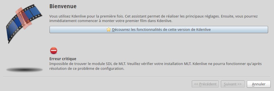

Hey,
I can't use Kdenlive. It fail at startup with this error :
Fatal Error
MLT's SDL module not found. Please check your MLT
install. Kdenlive will not work until this issue is fixed.
(see attached screenshot)
Tell me if I should open a bug about this.

Will it help to install lib64mlt5 and lib64mlt++? Likely kdenlive is missing some necessary requirements.

No those 2 package are already installed
I've also tried uninstall / reinstall without success :unknown:

Bug 1654 opened

Please try the test builds (URLs can be found in bug), the update solved issue for me.

It's Ok now with the update :beer:
