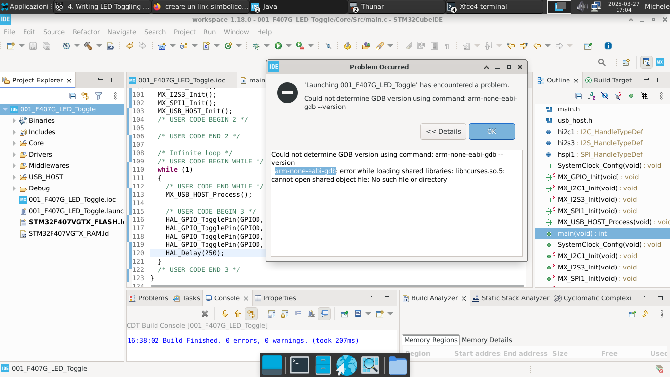

usando il programma STM32CubeIDE viene riscontrato questo problema:
STM32CubeIDE error nucrses library

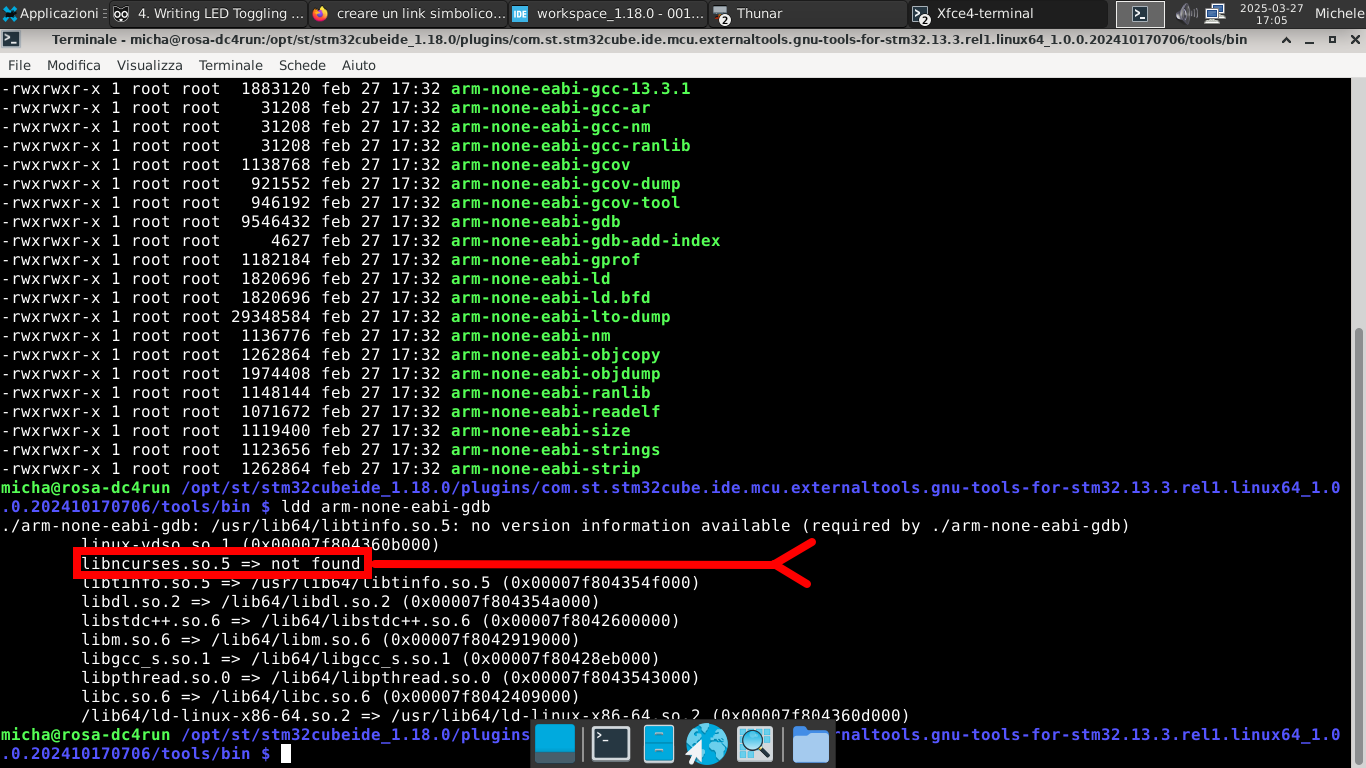

Indagando sull'eseguibile, non trova la libreria libncurses.so.5:
libncurses.so.5 not found

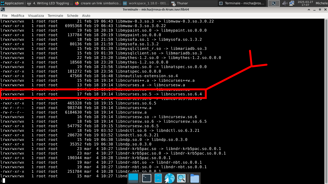

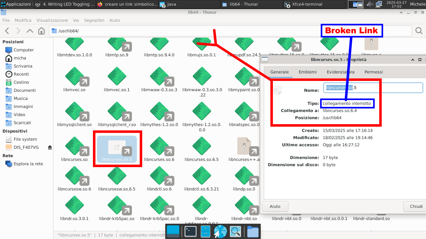

Ma nel filesystem è presente un collegamento, solo che punta ad un file inesistente di nome libncurses.so.6.4:
File non esistente
File non esistente
Broken Link
Broken Link

- using the STM32cubeIDE program this problem is encountered (1st image above)
- Investigating the executable, it does not find the library libncurses.so.5 (2nd image above)
- There is a link in the filesystem, but it points to a non-existent file named libncurses.so.6.4 (3rd & 4th images above)
From the spec file of the libncurses package there is a simple error in the third line;
%define	majorminor	6.4
here it is necessary to substitute 6.5 instead of 6.4 and everything is solved. :-)
