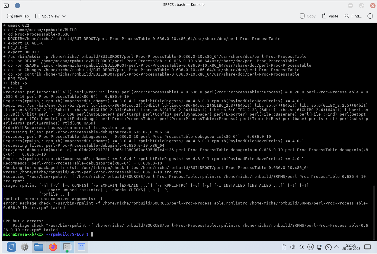

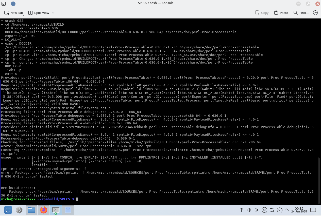

sto provando a creare il pacchetto rpm del modulo Perl "perl-Proc-ProcessTable" (https://metacpan.org/pod/Proc::ProcessTable), ma mi viene restituito l'errore:
rpmlint: error: unrecognized argument: -f
- Rosa 13 Plasma 6
- rpmlint versione 2.6.1
rpmlint error - unrecognized argument: -f

Hi,
I am trying to create the rpm package of the Perl module “perl-Proc-ProcessTable” (https://metacpan.org/pod/Proc::ProcessTable), but I get error:
(image above). Any idea?
- Rosa 13 Plasma 6
- version rpmlint 2.6.1
P.S.: I notice an inconsistency in the version of “perl-Number-WithError” package (https://metacpan.org/pod/Number::WithError); the latest version released is 1.01, but i see 1.10.0 (image above) in the package manager. Is there any mistake or "01" is interperted as "010 then "10""?

MikiLinux писал(а): 24 янв 2025, 02:49 (image above). Any idea?
check rpmlintrc file, you use project from other distro.

irton писал(а): 24 янв 2025, 15:21 use https://abf.rosa.ru/import/perl-Proc-ProcessTable
No, stesso errore. :(
Se provi tu a creare il pacchetto va a buon fine?
Sto usando la versione "ROSA_13_PLASMA6_x86_64_53791"
Domani proverò con la nuova ISO (53817) (https://abf.io/platforms/rosa13/product ... ists/53817).

No, same error. :(
If you try to create the package yourself, does it succeed?
I'm using "ROSA_13_PLASMA6_x86_64_53791"
Tomorrow I'll try with new ISO (53817) (https://abf.io/platforms/rosa13/product ... ists/53817).

You have enabled testing repo? in testing we have new rpm and it`s need more work for rignt use!!!!
See, i`m update this project https://abf.rosa.ru/import/perl-Proc-Pr ... a9311c14d4
