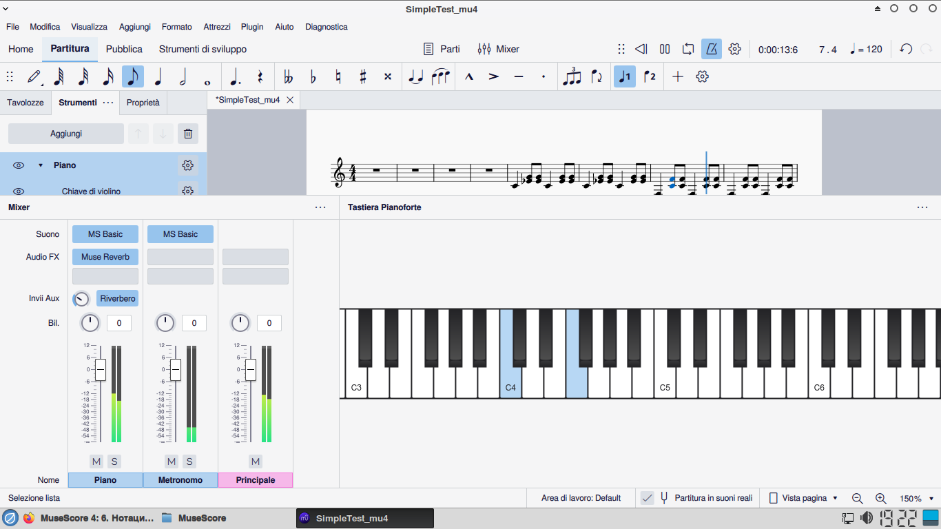

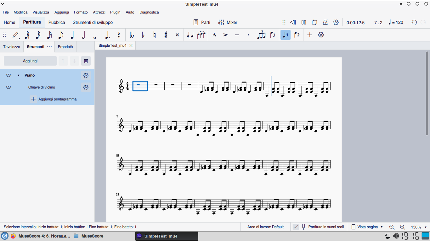

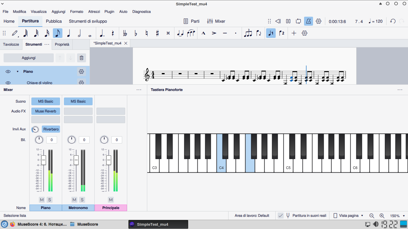

Esecuzione/Execution file SimpleTest_mu4.mscz

and so on. Enclosed a simple file test "SimpleTest_mu4.mscz".
Checking/correcting/testing any errors and add the change to the repository.
