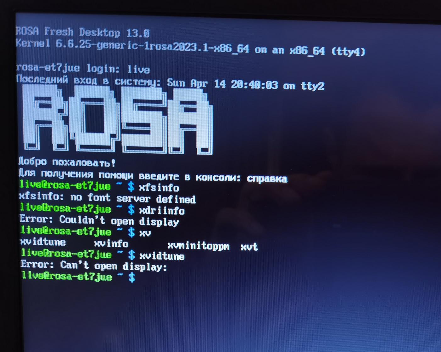

ROSA_2023.1_LXQT
Hello Victor, thanks for your help.
I tested the new ISO image.(ROSA_2023.1_LXQT_x86_64_50653.iso)
I still have the same issues.
It does not run GDM manager.
I can only run the graphics server from tty4 with the startx command.
Of course it's not GDM.
I have tested other ISO images (plasma5, gnome, xfce) that work correctly.
Kind regards
Kind regards

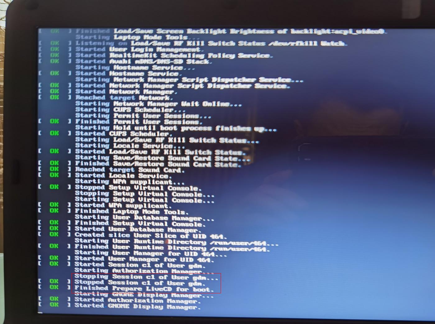

ROSA_2023.1_LXQT
Я добавил два скриншота в качестве примера
Первое изображение экрана-загрузка.
Второе изображение с терминала.
I've added two screenshots as an example.
The first screenshot is boot.
The second image is from the terminal.

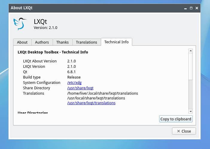

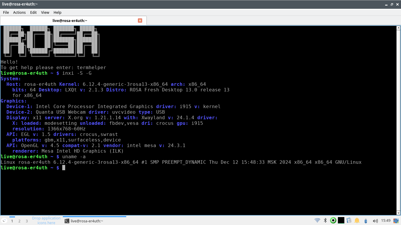

Good news for LXQt DE,
I tested the image of rosa13/53333 with the new LXQt 2.1.0 .
Display server: Xwayland v24. 1. 4, EGL v1. 5 .
Everything works very well with minimal loads CPU and memory footprint.
Congratulations, check it, you won't regret.

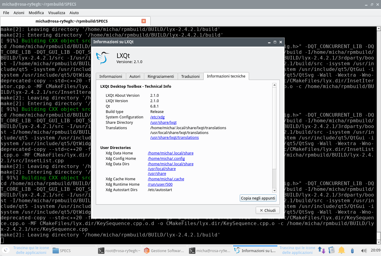

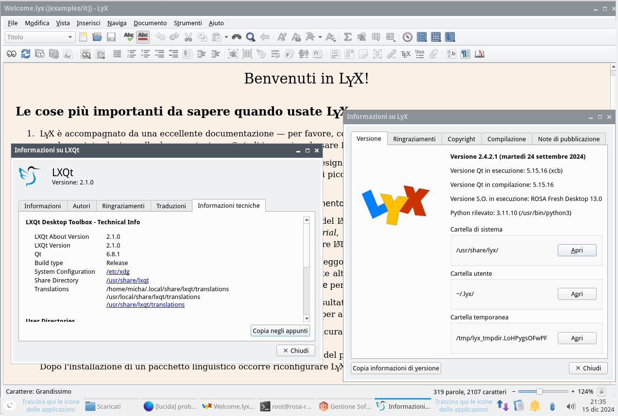

ROSA_2023.1_LXQT
Con Rosa13 LxQt non ho mai avuto alcun problema; la uso da circa 1 mese e funziona alla grande; leggera e molto veloce.
La uso per compilare l'aggiornamento dei programmi che provo prima in locale e poi provo a fare il Pull Request attraverso la piattaforma ABF.
Nelle figure la compilazione per l'aggiornamento e il lancio del software LyX che sembra funzionare senza alcun problema.
Nella giornata di domani proverò il Pull Request ...non garantisco nulla.

ROSA_2023.1_LXQT
Thank You Miki,
I have tried some older versions of the images that are no longer available in the repository.
The ones that started the Display server with no issues , are with LXQt 1.4.0.
Only with image 53333 and later with LXQt 2.1.0, the Display server boots correctly with my Intel integrated graphics card.
That's why I think we need to test new images with more complex hardware, AMD NVIDA graphics cards.
Kind regards
