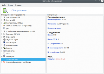

Здравствуйте, нужна помощь в подключении данного девайса. Устройство представляет собой сканер отпечатков пальцев.
вывод lsusb:
asupstudent@OUT-6-211 /usr/share/kde4/services $ lsusb
Bus 007 Device 001: ID 1d6b:0002 Linux Foundation 2.0 root hub
Bus 011 Device 001: ID 1d6b:0001 Linux Foundation 1.1 root hub
Bus 010 Device 001: ID 1d6b:0001 Linux Foundation 1.1 root hub
Bus 006 Device 001: ID 1d6b:0002 Linux Foundation 2.0 root hub
Bus 009 Device 001: ID 1d6b:0001 Linux Foundation 1.1 root hub
Bus 003 Device 003: ID 8564:1000 Transcend Information, Inc. JetFlash
Bus 003 Device 001: ID 1d6b:0002 Linux Foundation 2.0 root hub
Bus 008 Device 002: ID 1c4f:0034 SiGma Micro
Bus 008 Device 004: ID 04f3:0c28 Elan Microelectronics Corp.
Bus 008 Device 001: ID 1d6b:0001 Linux Foundation 1.1 root hub
Bus 005 Device 001: ID 1d6b:0003 Linux Foundation 3.0 root hub
Bus 004 Device 001: ID 1d6b:0002 Linux Foundation 2.0 root hub
Bus 002 Device 001: ID 1d6b:0003 Linux Foundation 3.0 root hub
Bus 001 Device 001: ID 1d6b:0002 Linux Foundation 2.0 root hub
в системе определяется как
Спасибо

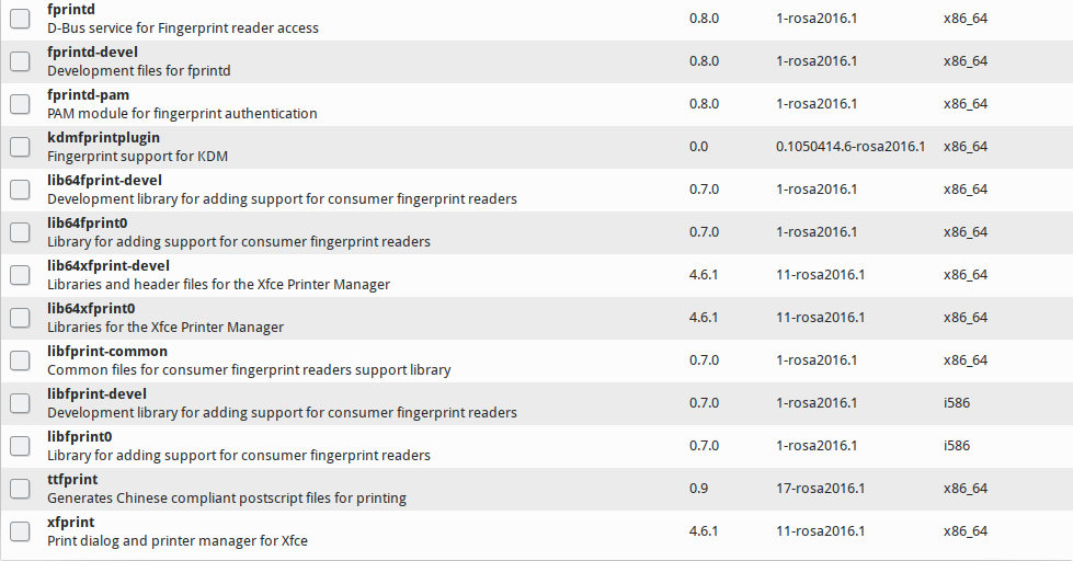

В репозитории версия libfprint v0.7.0, а для поддержки данного девайса нужна как минимум v0.8.0
2018-06-12: v0.8.0 release
- Port to meson as the build system
- Port documentation to gtk-doc
* Drivers:
- Add Elan driver
- Increase threshold to detect encryption on URU4000 devices
- Remove already replaced UPEKE2 driver
- Fix possible crash caused by vfs5011 when no lines were captured
* Library:
- Fix a number of memory and file descriptor leaks and warnings
- Make NSS (and URU4000) driver optional
- Fix assembling of frames for non-reverse and non reverse stripes
- Split internal private header to clarify drivers API
- Simplify logging system, now all the builds can be used to output
debug information
- Mark fp_dscv_print functions as deprecated
* Udev rules:
- Add some unsupported devices to the whitelist
Последняя версия 2020-06-08: v1.90.3 release

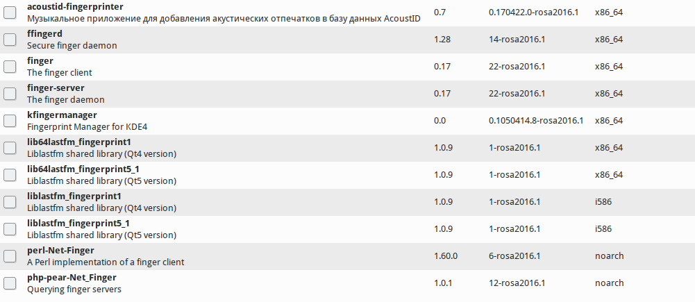

Как мне найти пакет? спасибо
Либо собирать из исходников?
