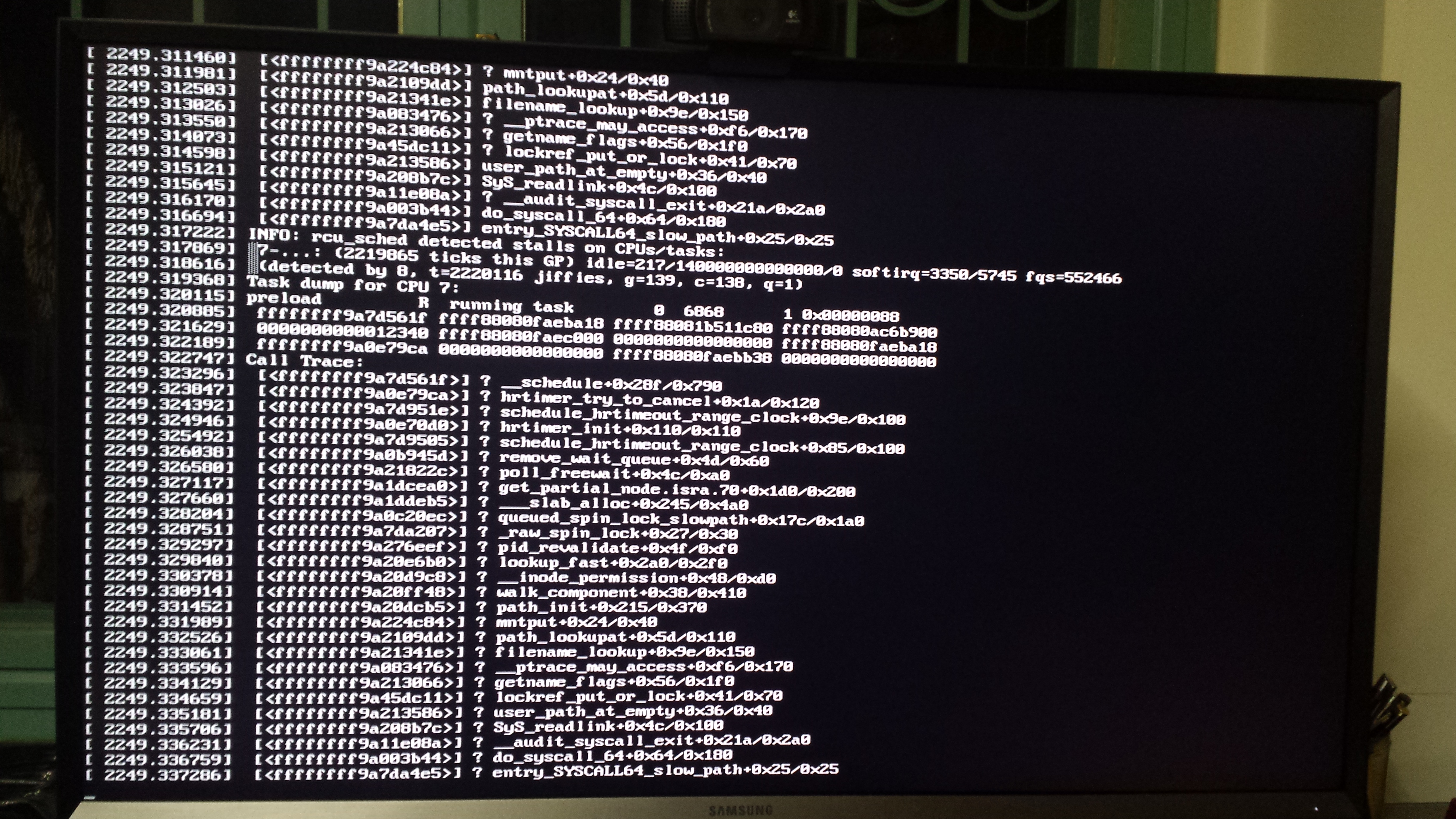

Unfortunately. pressing [ctrl-alt-F2] does not take me to a working console, but only to the screen shot that you can see in the two attached pictures. Substantially the image remains the same over the time and only from time to time it is updated, but only the leftmost numbers change. The two pictures have been taken at approximately 30 minutes of distance.

There were errors before these ones, it seems, and the first ones are usually the most meaningful.
Could you try the following. Try to boot with the kernel 4.8.x again, wait till the problem happens.
Then, if your keyboard has SysRq key, press alt-sysrq, then (while keeping alt-sysrq pressed) - 'R', 'E', 'I', 'S', 'U', 'B'. The system may reboot as a result, which is OK. If it does not reboot, reboot it manually.
Now boot with the kernel 4.7.x that worked for you. Then, please run hw-probe tool I mentioned earlier to upload the hardware info and the logs to us. hw-probe will try to collect the logs from the previous boot as well. So, if we are lucky, we will get more info about that system crash and lockup.

I see now, looks like this is the same problem with 'wl' driver for Broadcom WiFi adapters some other our users encountered not long ago with kernel 4.8. Hopefully, I will have time for it in a day or two.
In the meantime, you can either continue to use kernel 4.7.x or you can remove dkms-broadcom-wl - the system will try to use the in-kernel opensource driver for that WiFi adapter instead.
