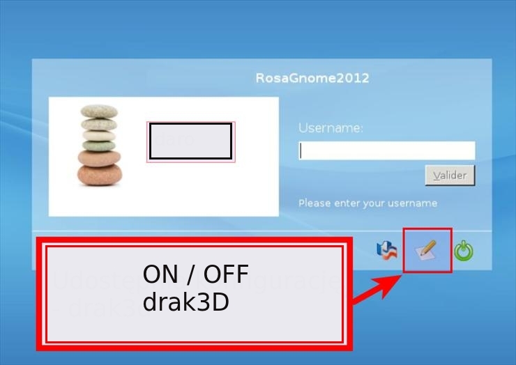

Install the following packages:
drak3D - is an essential package for proper operation "compiz-fusion".
CompizConfig Settings Manager. ( System> Preferences> CompizConfig Settings Manager )
Package called "compiz-fusion-plugins-extra", increases the amount of plug-in that manager.
After installation, all the packages, you must enable the "Compiz Fusion" - ( Photo-No.1 ).
You can do this by:
1 # command in the terminal
2 # create a desktop Launcher of the above command.
3 # Logout, then select the icon shown on the (Photo-No.2) - so you get control over turning on or off, 3D effects (Photo-No.1).
The next step is selecting the log.
Mileage to install "compiz-fusion".
As a window decorator, Emerald controls the appearance of your window borders; please see your desktop environment's own theme settings if you wish to change the appearance of things inside windows, such as buttons, menus and scrollbars.
http://wiki.compiz.org/EmeraldThemeManager
Access to the program by: [System] -> [Preferences] -> [Theme Manager - Emerald]
For proper operation, Emerald Theme Manager requires the following:
1 # the option "Compiz Fusion - 3D" - (Photo-No.1).
2 # install the package "Compiz Fusion Icon"
3 # start-up and configuration - "Compiz Fusion Icon"
[System] -> [Administration] -> [Compiz Fusion Icon]
Pfter starting the application from the context menu (the lower photo) choose the option "Select Window Decorator" and then select "Emerald", from this point we should be able to change the borders with "Emerald Theme Manager".
urpmi drak3dКод: Выделить всё
urpmi compiz-fusionКод: Выделить всё
urpmi compiz-fusion-plugins-extra ===========================================================================================
You can do this by:
drak3d3 # Logout, then select the icon shown on the (Photo-No.2) - so you get control over turning on or off, 3D effects (Photo-No.1).
