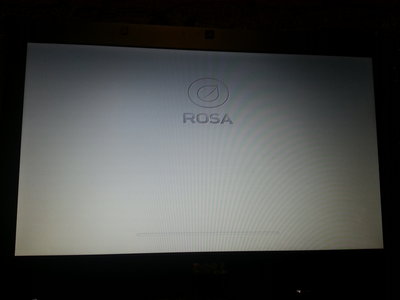

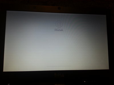

I can confirm that on my laptop with Intel graphics I had same issue. During boot Rosa logo was much bigger then in shutdown process. It also was distorted (4:3 resolution instead of 16:9), so Rosa logo was an ellipse instead of circle. :(
After I installed new kernel (nrj-netbook from MIB) those problems was gone. :Yahoo!:
I made disk image just after fresh install and first boot, so I restored that image and took those pics in attachment. :wink:
Now I need to restore my latest disk image so I can continue my work. 8)
Rosa logo is much smaller during shutdown then in boot process
Rosa logo is much bigger during boot then in shutdown process

ДроноваЮ писал(а):You see, the problem is that while initializing the system we have the 'vga=788' option in the kernel, right? But during shutdown the system default graphical settings are working. Don't know if there is any easy solution for that.
Yes, that's true, there is vga=788 in menu.lst, but... what happens during boot process is diffident with diffident kernels.
With originally shipped kernel (was it 3.0.28?), it was like in pictures I posted. 800x600 (788) was active until KDM shows up. KDM was in my native resolution (1366x768), and everything after that was in same resolution.
With 3.4.7-nrj-netbook (and with 3.4.6) situation is different. On boot, 800x600 (788) resolutions is active only until grub ends and boot screen with Rosa logo shows. From that moment, everything until end of shutdown is in my native resolution (1366x768). So basically this means that both screens in pics that I sent looks same on my current system (with small proper circle Rosa logo). I am not sure if Automatically start the graphical interface upon booting also have something to do with that.
