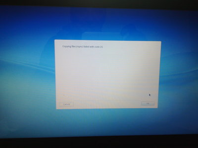

Hello ! I again !!
Download ROSA.FRESH.KDE.R7.15218.b.x86_64.uefi.iso - 2016-05-26 - Latest version
1. Shrink windows partition and give install : Use the free space on a Microsoft Windows partition - I think this is better !!
But after finish installations I get this message :
Coping file (sync) failed with code 23
That is firs way on which I tray install on UEFI Rosa.
Later I will tray install : Custom disc partitions !
I already install on a few PC and Laptop Rosa,but without UEFI , and that it is not problem for me , but UEFI is something else !!??
REGARDS
Goran

Re: UEFI
According to man rsync,
in other words, it means either lack of permissions or insufficient / unavailable space. Perhaps, it would be reasonable to create partitions manually (including EFI partition which must be not less than 35 Mb and labeled as EFI) and then try to install the system “on the existing partitions”.
23 Partial transfer due to errorTalk is cheap. Show me the code.
