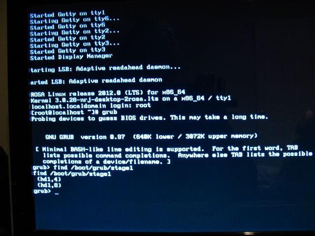

I know this is an old thread, but I wanted to try the Rescue System on my ROSA 2012 Marathon EE 64 bit disc to see what you are all referring to.
I have two hard drives on my desktop. The first has two windows (XP Pro Nlite and 8 Devel Preview) and second hard drive has two Linux distros, the first is ROSA with its grub installed on the first hard drive of the Master Boot Record.
I tested the Rescue System and chose the Grub => MBR & !Linux (1) auto ; - ) but it hangs on "Running embed boot /grub/e2fs_stage1_5
it never finishes. So, in case if anyone else wants to try and reinstall grub, this is what I do. I find it fairly simple to do, only because I have had lots of practice reinstalling the grub menu.
Insert ROSA disc, at menu, hit 'enter' after Launch System...
At Select Language screen, hit Ctrl+Alt+Del to bring you to console which will show what is in image one.
localhost@localdomain
Type "root" without quotes, then hit 'enter'
root@localhost ~]#
Type "grub" without quotes, then hit 'enter'
Probing devices to guess BIOS drives. This may take a long time....Minimal Bash-like line editing is supported...
grub>
Type "find /boot/grub/stage1" without quotes, and hit 'enter'
(hd1,4)
(hd1,8)
and this will list possible grub boot files.
(I have two. hd1,4 is where Rosa is installed with boot loader installed on hd0 to MBR of Windows. Second one, hd1,8, is another Linux distro where during installation I allowed grub to install to that distro's root partition, not the MBR. This way I can easily boot into ROSA, go to file manager, mount that distro's root partition, look at its /boot/grub/menu.lst (unmount said partition after I am finished with it) and add its entry to my ROSA menu.lst so it will appear in ROSA's boot menu. Back to reinstall grub for ROSA...)

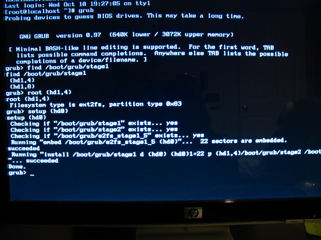

grub>
Type "root (hdx,x)" where your grub entry is, without quotes, and hit 'enter'
(For my system it would be root (hd1,4) as that is partition where my ROSA grub entry is located.)
Filesystem type is ext2fs, partition type 0x83
grub>
Type "setup (hd0)" to install grub to MBR, without quotes, and hit 'enter' as seen in image 3
setup (hd0)
Checking if....stage1 exists...yes
Checking if ...stage2 exists...yes
Checking if ...e2fs_stage1_5 exists...yes
Running "embed /boot/grub/e2fs_stage1_5 (hd0)"...22 sectors are embedded.
succeeded
Running "install /boot/grub/stage1 d (hd0) (hd0)1+22 p (hd1,4)/boot/grub/stage2 /boot/grub/menu.lst
...succeeded
Done.
grub>
Type "quit" without quotes, and hit 'enter'
then hit 'Ctrl+Alt+Del' to reboot the system
Disc does not eject. Upon booting up disc, select, 'boot from hard drive', and you will be brought back to your reinstalled boot grub menu, and after starting up your selected operating system you can eject the disc.
Any other suggestions are more than welcome.
(Oops, I used "Place inline" for each image but they showed twice for some reason, so instead I placed them at bottom of text. )
image 1
image 1
image 2
image 2
image 3
image 3

Today I had success with Rescue System in Rosa DVD install disc, even after it showed
"Running embed /boot/grub/e2fs_stage1_5 (hd0)..."
where it never continues after this point.
I had to hard restart computer, but I got my Rosa simple graphical boot menu back.
Lisa

(edited as I meant to write, non-free)
Hi,
Rosa Marathon 2012 non-freex86_64
restored the GNU GRUB .97 menu.
I'll try posting a couple of images from the output excluding first image since previous poster shared it already:
