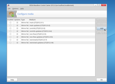

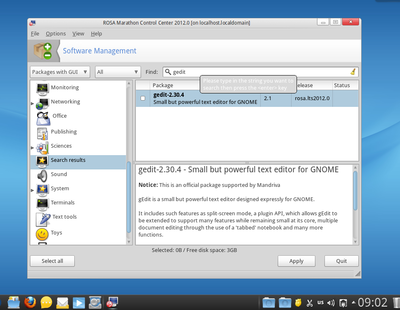

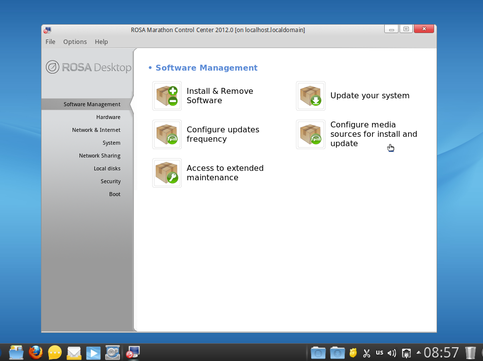

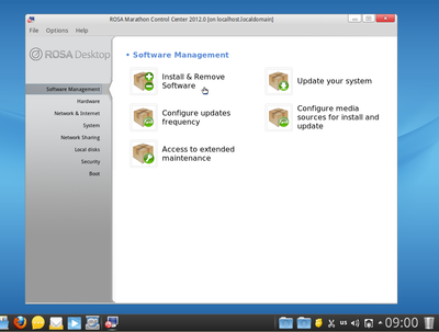

Re: Add Programs
See pictures, step by step:
Please ask any additional questions
In my system media were already added, in your case the list will be empty, but the steps are the same.

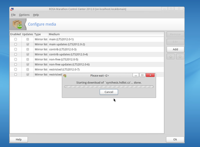

Re: Add Programs
I tried to do it that way first before I posted. After you answered the post I tried again.
When I tell it to update it will start and then a warning comes up and said it fell to
update. Try back later and I have for two days with the same reply.

Re: Add Programs

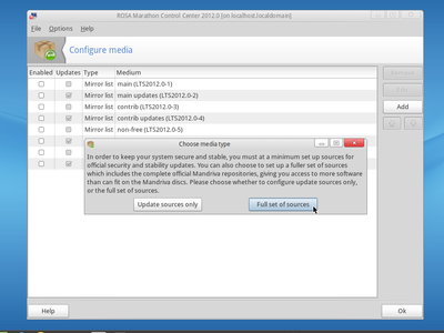

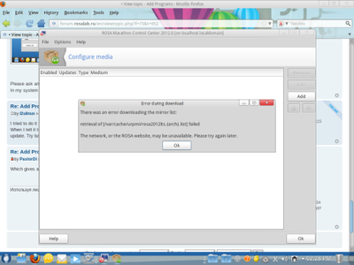

This is what happens?
First is when you go to file and use the add media mirror.
Second picture is when you tell it to add.
Re: Add Programs
Write in terminal:
and try to add mirrors.
rm -rf /var/cache/urpmi/mirrors.cacheRe: Add Programs
Thank you very much, that solved the problem. I have to keep punching the add button to get to download all the mirrors but that is ok.

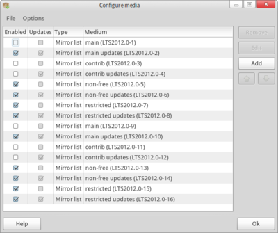

This how-to helped me also. I assumed 'media' was referring to disk, so I didn't click 'add', but now that I did, I retrieved the package list.
I received this;
so I clicked,'add' again and it re-retrieved the package list, and now I have double entries as you can see in this snapshot.
Should I delete the extra mirrors?
I wanted to install digikam for photo management, which was main reason I was doing update in package manager. I don't see it. Is it in one of the mirrors that is not ticked? Thank you!
