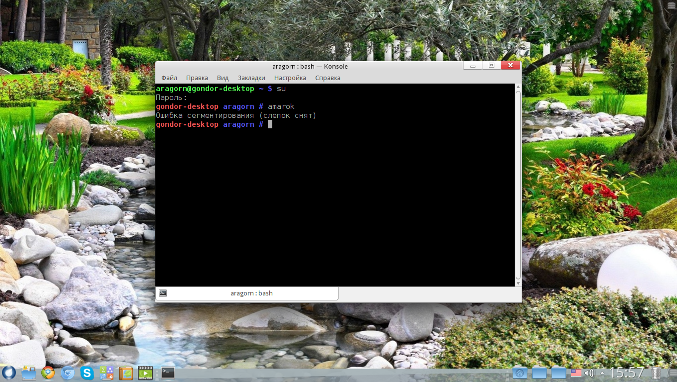

Ошибка сенгментирования(слепок снят) Скриншот выше... Ещё варианты будут?

gondor-desktop aragorn # ldd amarok
ldd: ./amarok: Нет такого файла или каталога
gondor-desktop aragorn # amarok
Ошибка сегментирования (слепок снят)
gondor-desktop aragorn # dmesg | tail -f
[  175.501399] systemd-journald[371]: Failed to write entry (26 items, 7340781 bytes) despite vacuuming, ignoring: Argument list too long
[  181.152049] systemd-journald[371]: Deleted empty journal /var/log/journal/2c667077c2962149a8be4f53535a5d92/user-500@ed8222ddc094470dbc80775da6555635-0000000000000000-0000000000000000.journal (6553600 bytes).
[  181.152137] systemd-journald[371]: Vacuuming done, freed 13107200 bytes
[  181.161248] systemd-journald[371]: Failed to write entry (26 items, 7332592 bytes) despite vacuuming, ignoring: Argument list too long
[  187.660347] systemd-journald[371]: Deleted empty journal /var/log/journal/2c667077c2962149a8be4f53535a5d92/user-500@ed8222ddc094470dbc80775da6555635-0000000000000000-0000000000000000.journal (6553600 bytes).
[  187.660426] systemd-journald[371]: Vacuuming done, freed 13107200 bytes
[  187.669433] systemd-journald[371]: Failed to write entry (26 items, 7336688 bytes) despite vacuuming, ignoring: Argument list too long
[  307.346192] amarok[13028]: segfault at 4 ip b7789956 sp bfd31190 error 4 in ld-2.15.so[b777e000+1f000]
[  307.559982] systemd-journald[371]: Vacuuming done, freed 13107200 bytes
[  307.573966] systemd-journald[371]: Failed to write entry (26 items, 11494019 bytes) despite vacuuming, ignoring: Argument list too long
И как это понимать? :evil: :evil: :evil:
