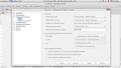

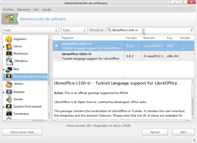

Hi Majestic..
No this straight, but if it is what I believe, you may try the following:
Open RPMDrake (Installing and removing software) and enter libreoffice-l10n-tr in your search terms.
Install it according to your software / architecture (32bit or 64bit) And then go to Libre Office. Sign in to Tools> Options> Language Settings.
And then select the Turkish language you finished installing. I hope this serves you.
Says to see if it worked.
Sorry for my english (By Google traslate) is that I speak Spanish.
