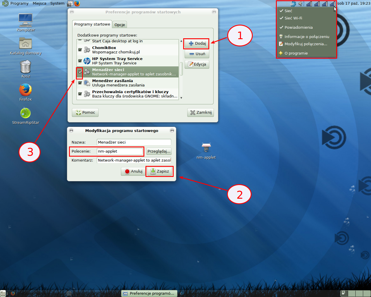

You should also add the applet to autostart
System-> Preferences-> Startup programs
nm-appletWhat to install a mate environment: http://pkgs.org/download/task-mate
