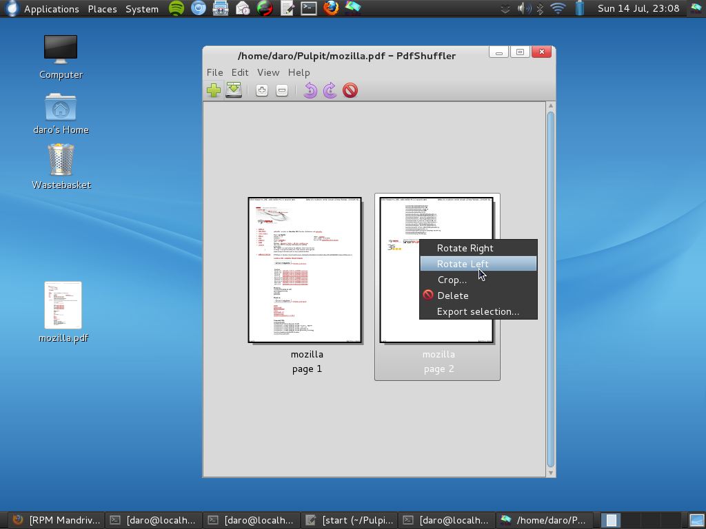

dareksmok
ROSA 2012 MARATHON GNOME i586
installation of repositories ROSA
[daro@localhost ~]$ su
Password:
[root@localhost daro]# urpmi pdfshuffler
Package Version Release Dist DEpoch Arch
(medium "contrib (LTS2012.0-3)")
pdfshuffler 0.5.1 2 rosa> 2012.0 noarch
(medium "contrib updates (LTS2012.0-4)")
python-pypdf 1.13 1 rosa> 2012.0 noarch
python-pypoppler 0.12.1 4 rosa> 2012.0 i586
360KB of additional disk space will be used.
187KB of packages will be retrieved.
Proceed with the installation of the 3 packages? (Y/n) y
$MIRRORLIST: media/contrib/release/pdfshuffler-0.5.1-2-rosa.lts2012.0.noarch.rpm
$MIRRORLIST: media/contrib/updates/python-pypoppler-0.12.1-4-rosa.lts2012.0.i586.rpm
$MIRRORLIST: media/contrib/updates/python-pypdf-1.13-1-rosa.lts2012.0.noarch.rpm
installing python-pypoppler-0.12.1-4-rosa.lts2012.0.i586.rpm python-pypdf-1.13-1-rosa.lts2012.0.noarch.rpm pdfshuffler-0.5.1-2-rosa.lts2012.0.noarch.rpm from /var/cache/urpmi/rpms
Preparing... #############################################
1/3: pdfshuffler #############################################
2/3: python-pypoppler #############################################
3/3: python-pypdf #############################################
START
[daro@localhost ~]$ pdfshuffler %F
** (process:18904): WARNING **: Trying to register gtype 'GMountMountFlags' as enum when in fact it is of type 'GFlags'
** (process:18904): WARNING **: Trying to register gtype 'GDriveStartFlags' as enum when in fact it is of type 'GFlags'
** (process:18904): WARNING **: Trying to register gtype 'GSocketMsgFlags' as enum when in fact it is of type 'GFlags'
File "/usr/bin/pdfshuffler", line 1027, in <module>
PDFshuffler()
File "/usr/bin/pdfshuffler", line 276, in __init__
self.add_pdf_pages(filename)
File "/usr/bin/pdfshuffler", line 349, in add_pdf_pages
pdfdoc = PDF_Doc(filename, self.nfile, self.tmp_dir)
File "/usr/bin/pdfshuffler", line 922, in __init__
mime_type = f.query_info('standard::content-type').get_content_type()
gio.Error: Error when getting information for file '/home/daro/%F': No such file or directory
edited: 2013.07.23
It seems that the package &quot;pdfshuffler-0.5.1-2-rosa.lts 2012.0.noarch.rpm&quot; is broken - because when you run the program does not contain a control panel.
It seems that the package "pdfshuffler-0.5.1-2-rosa.lts 2012.0.noarch.rpm" is broken - because when you run the program does not contain a control panel.
installation of "pdfshuffler-0.6.0-1-mdv2011.0.noarch.rpm"- (Mandriva 2011) http://rpm.pbone.net/index.php3/stat/4/ ... h.rpm.html
[root@localhost daro]# urpmi /home/daro/Destop/pdfshuffler-0.6.0-1-mdv2011.0.noarch.rpm
(command line)
pdfshuffler 0.6.0 1 mdv 2011.0 noarch
393KB of additional disk space will be used.
107KB of packages will be retrieved.
warning: /home/daro/Pulpit/pdfshuffler-0.6.0-1-mdv2011.0.noarch.rpm: Header V3 DSA signature: NOKEY, key ID 26752624
The following package has bad signature:
/home/daro/Pulpit/pdfshuffler-0.6.0-1-mdv2011.0.noarch.rpm: Invalid signature (NOT OK (no key): /home/daro/Pulpit/pdfshuffler-0.6.0-1-mdv2011.0.noarch.rpm: Header V3 DSA signature: NOKEY, key ID 26752624)
Do you want to continue installation ? (y/N) y
installing /var/cache/urpmi/rpms/python-pypoppler-0.12.1-4-rosa.lts2012.0.i586.rpm
/var/cache/urpmi/rpms/python-pypdf-1.13-1-rosa.lts2012.0.noarch.rpm
START
** (process:19136): WARNING **: Trying to register gtype 'GMountMountFlags' as enum when in fact it is of type 'GFlags'
** (process:19136): WARNING **: Trying to register gtype 'GDriveStartFlags' as enum when in fact it is of type 'GFlags'
** (process:19136): WARNING **: Trying to register gtype 'GSocketMsgFlags' as enum when in fact it is of type 'GFlags'
File "/usr/bin/pdfshuffler", line 31, in <module>
main()
File "/usr/lib/python2.7/site-packages/pdfshuffler/pdfshuffler.py", line 1084, in main
PdfShuffler()
File "/usr/lib/python2.7/site-packages/pdfshuffler/pdfshuffler.py", line 273, in __init__
File "/usr/lib/python2.7/site-packages/pdfshuffler/pdfshuffler.py", line 418, in add_pdf_pages
File "/usr/lib/python2.7/site-packages/pdfshuffler/pdfshuffler.py", line 1027, in __init__
[daro@localhost ~]$
The program works OK.
