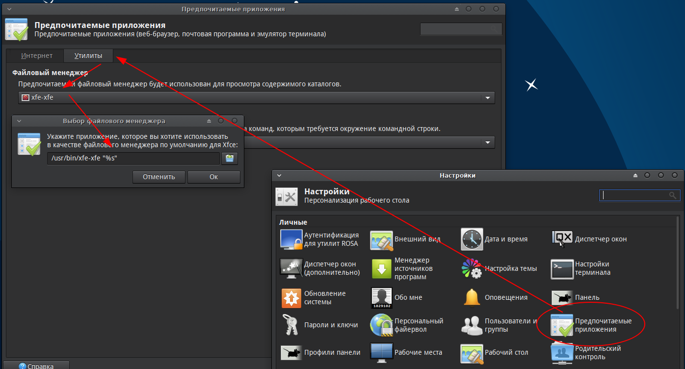

I want to know how, if possible, can i change the default file manager of my Rosa R11 xfce.
The default is Thunar, and I want to use XFE.
I already have found and installed XFE on Synaptic. But the system can not see it on XFCE's preferred applications.ried
I have tried to just write "XFE" on it, but that did not work.
Any way to do this?
Thank you in advance.
Change the default file manager
Yes, asa! That worked. Thank you for your help
