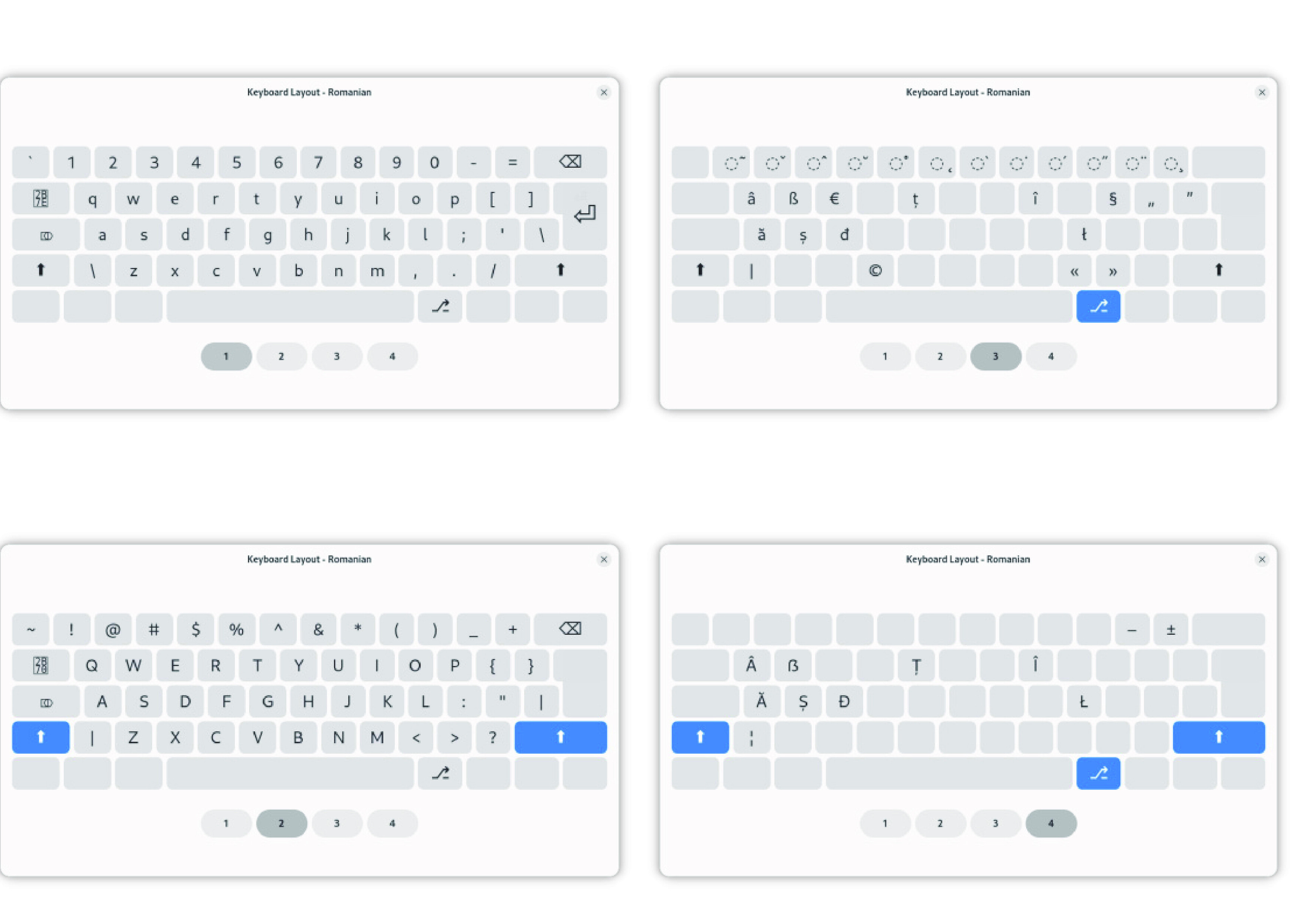

After an update BIG problem arised with keyboard layouts. The layouts are incorrect. The problem has to be somewhere in plasma, because outside of it - on tty or mate desktop for example and the files in /usr/share/X11/xkb/symbols/ everything works correctly. The problem is on the isos too, not only on my installation.
I tried to roll back my installation, but no help. The problem remained. I don't know what to do.
I need urgent solution, because it is difficult, or partly impossible to use the keyboard for writing. Problematic is the level activated by ALT Right key (ISO Level3 Shift).

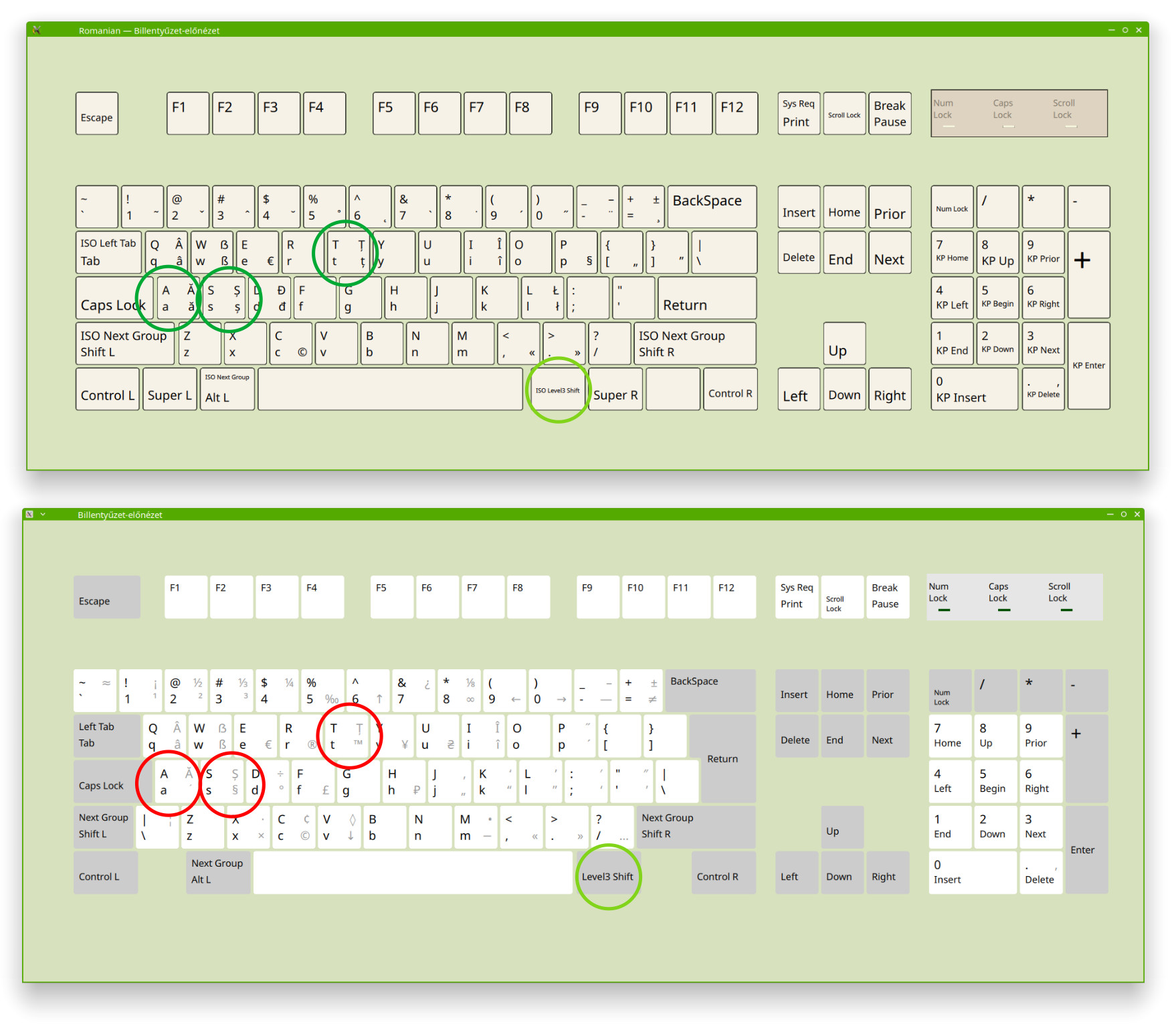

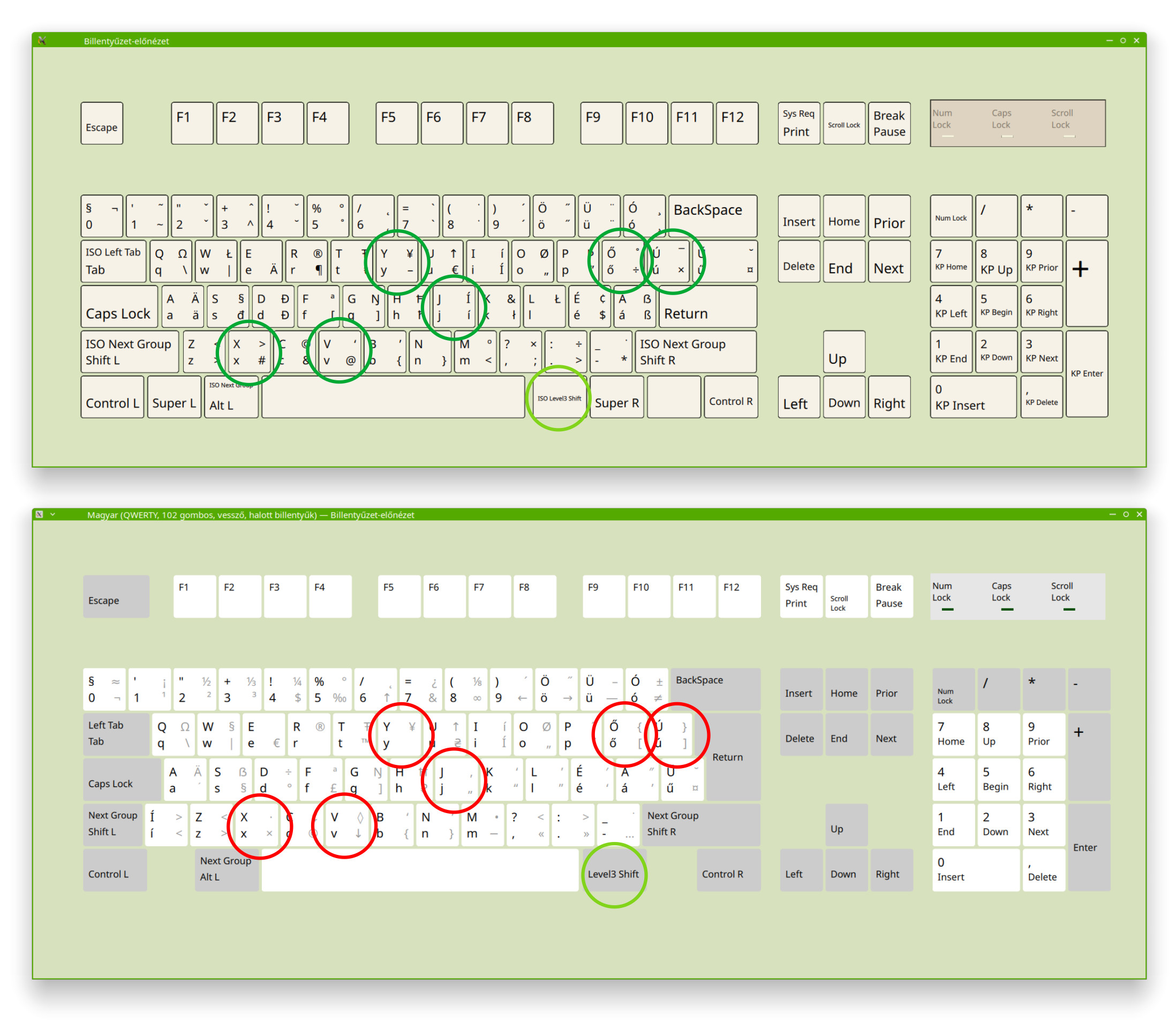

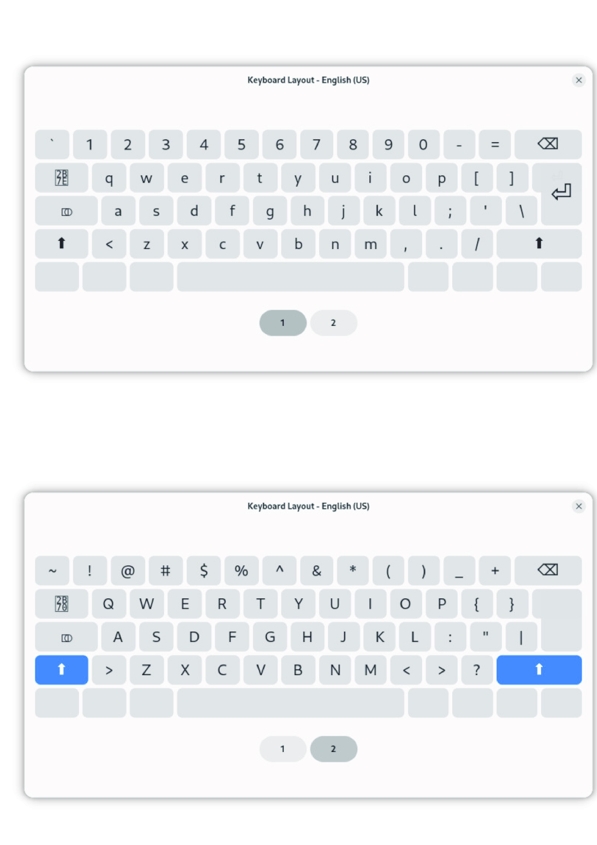

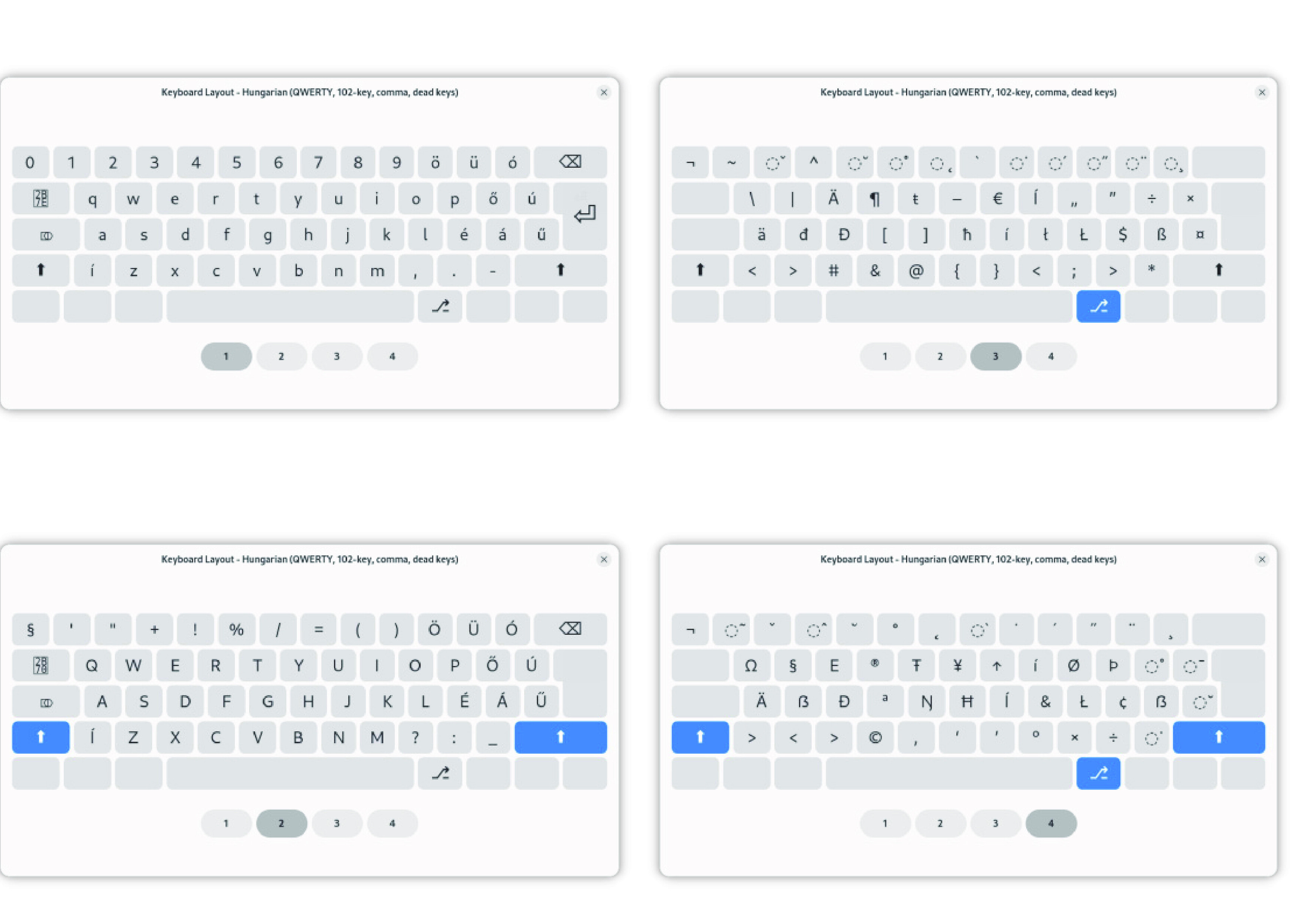

In the attachments the upper image is the correct layout, and under it is the Rosa plasma layout. I noted with green and then red circles the keys which I use normally and are not alright anymore. There are also other differences, as you can see, but I marked the most important ones for me.

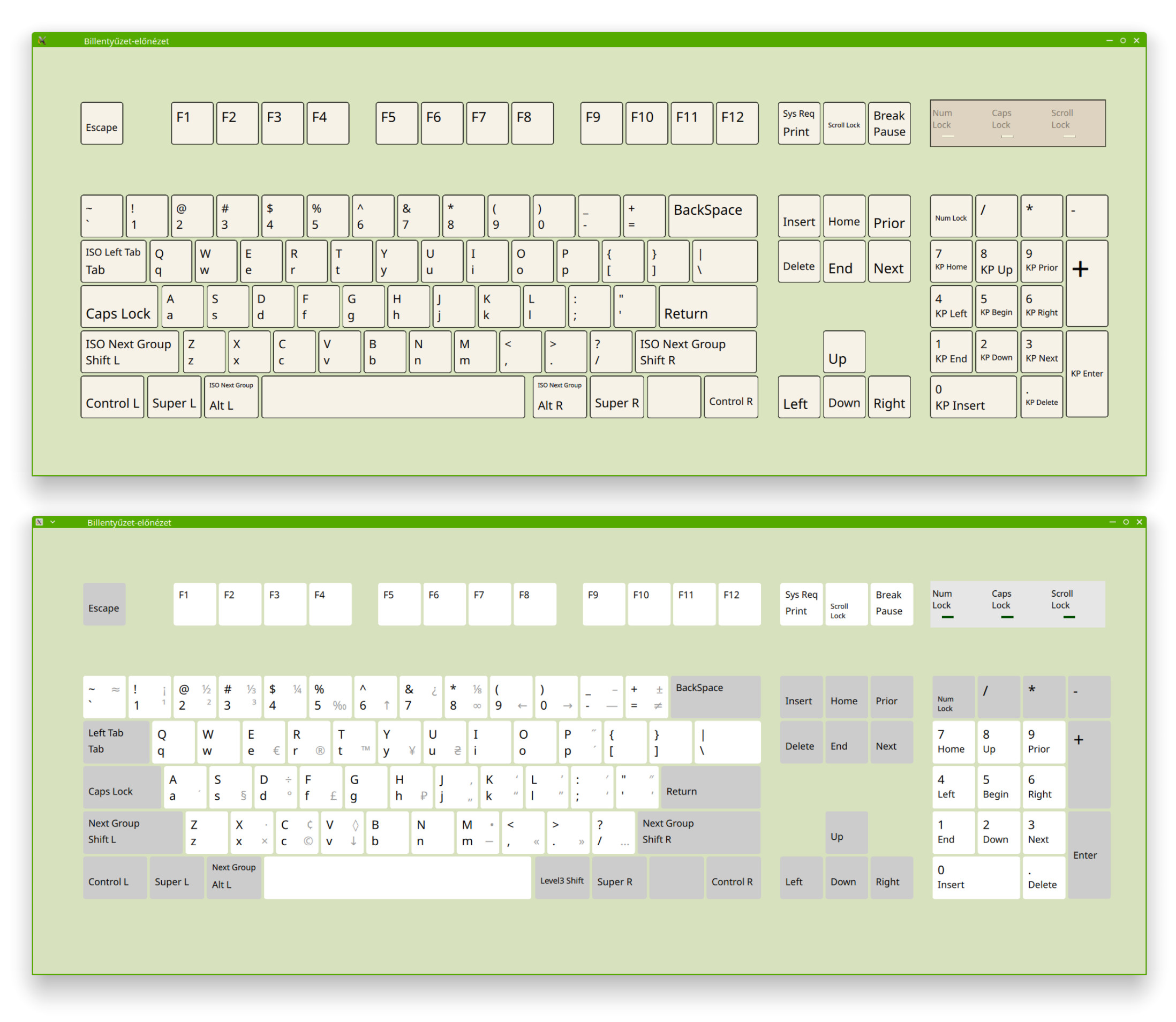

I attach the US layout too, to see how different is the normal layout and Rosa's layout.
Thank You!
Thank You!

But look at the ENGLISH US layout. The normal layout has NO CHARACTERS on the ALT R activated level. And on Rosa it is plenty with characters. And these characters from this level seems to interfere with the other language layouts, overwriting them.

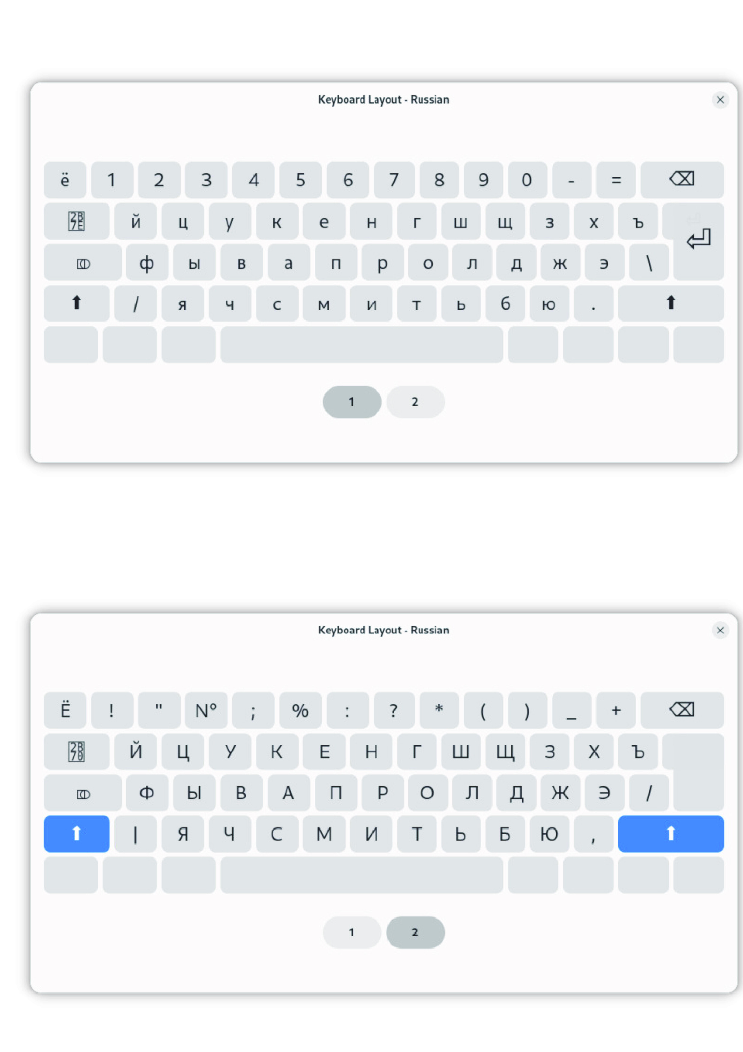

It is a unique setting and specific only for Rosa Plasma. It is the same on all updated Plasma isos - Rosa 13.1 Plasma 5 & 6 and Rosa 2021.1 Plasma 5.
Which package or setting is responsible for this, for creating a third and forth level on basic english or russian layouts too, layouts which normally has NO third and forth level, which overrides other language layout's ALT R activated levels?
On Rosa 13.1 Gnome iso everything is OK.

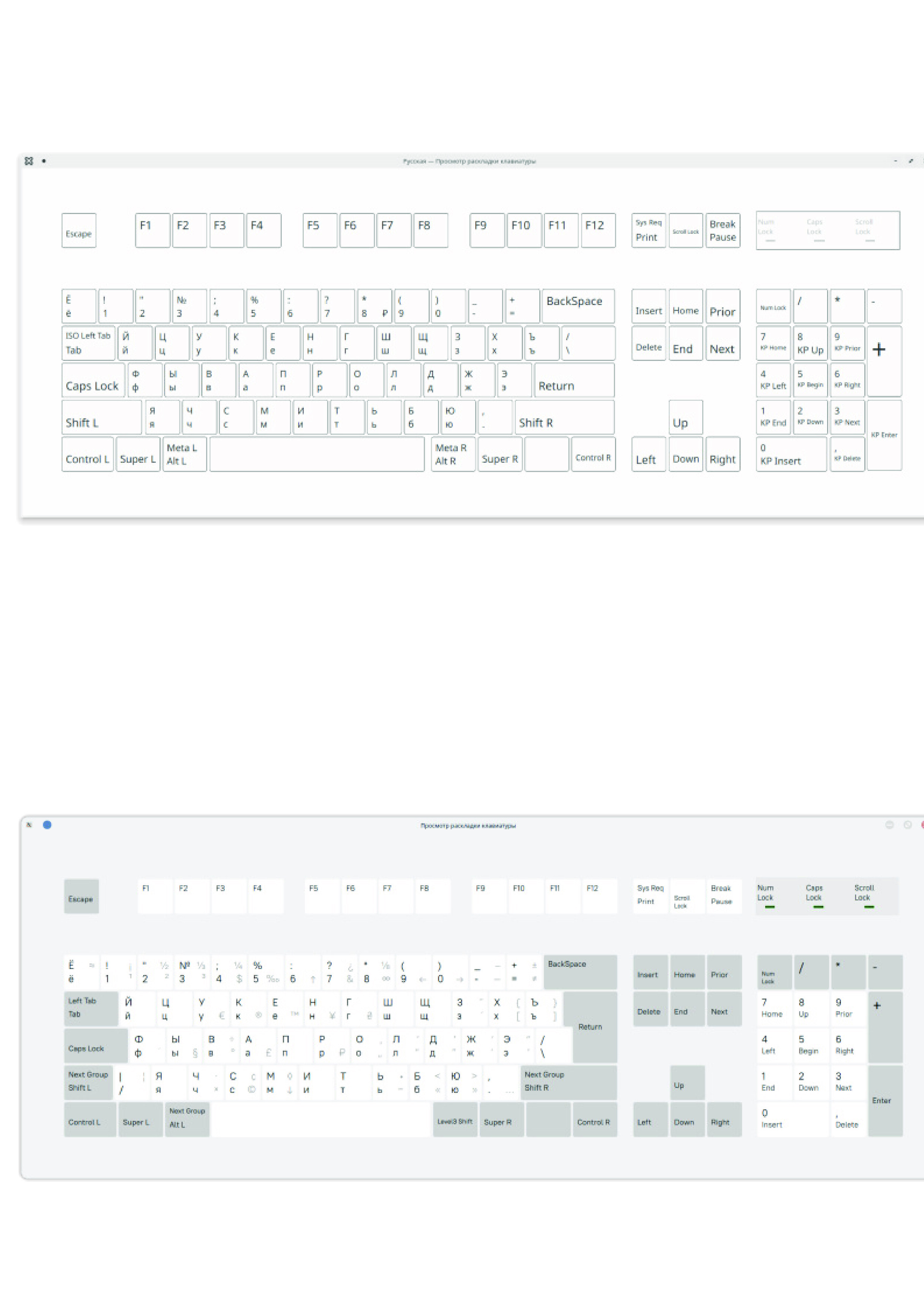

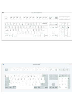

In the last image I compared two russian distros - the russian layout from RedOS 8.0.2 Plasma 5 and Rosa 13 Plasma. Look how clean is the normal russian layout in RedOs, and how full of ALT R activated character the one on Rosa.

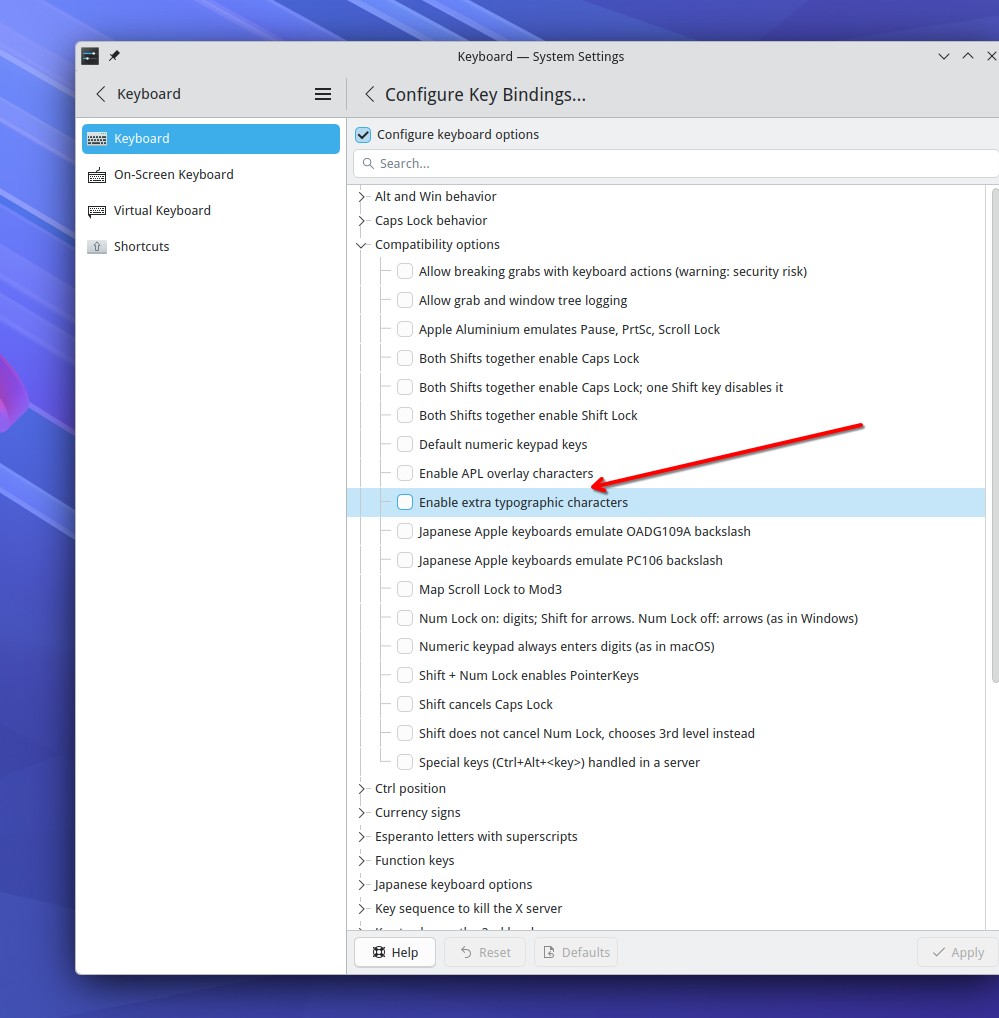

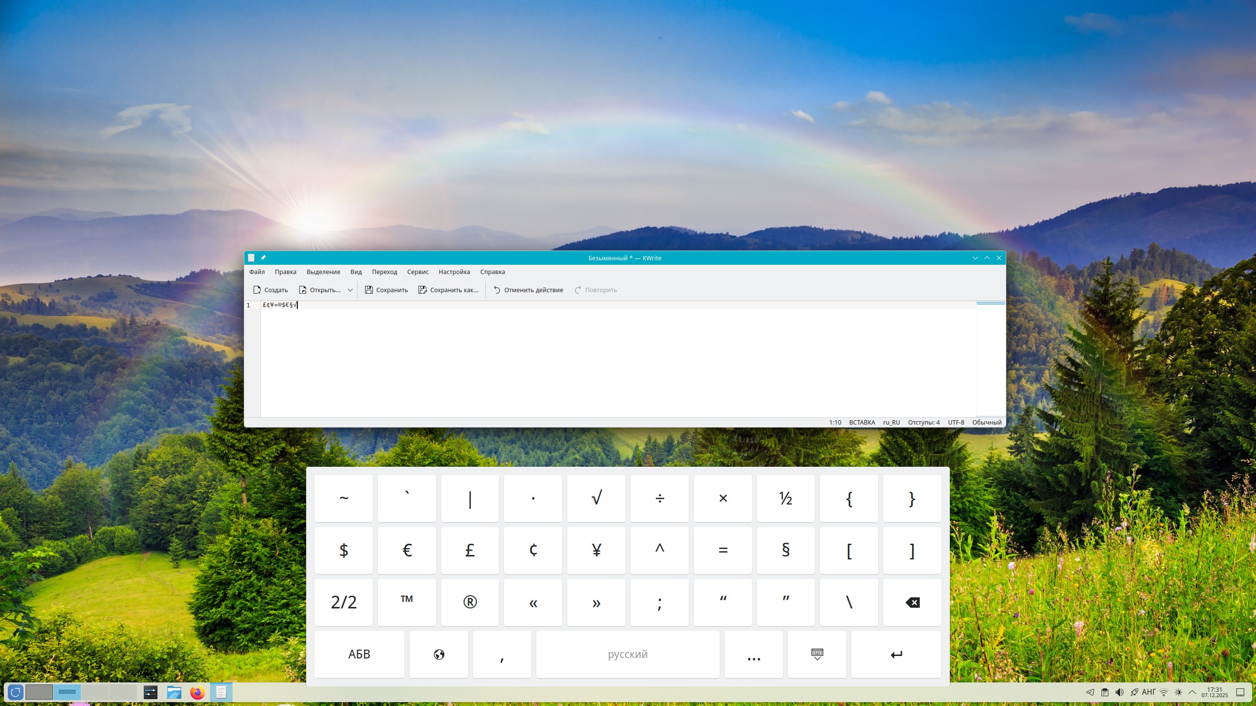

Well, yes, these are symbols that are enabled in the KDE settings. Typographic symbols.erfan писал(а): 06 дек 2025, 22:30 In the last image I compared two russian distros - the russian layout from RedOS 8.0.2 Plasma 5 and Rosa 13 Plasma. Look how clean is the normal russian layout in RedOs, and how full of ALT R activated character the one on Rosa.
I always have them enabled because I need to enter additional symbols while working.
For example, the symbols »»»» «««««
Ну да, это символы, которые включаются в настройках kde. Типографские символы.
У меня они всегда включены, так как нужно вводить дополнительные символы в процессе работы.
Например, символы »»»» «««««
- Сообщения: 8447
Re: Need URGENT solution! Plasma 6 keyboard layout BIG problem.
They are also available in the virtual keyboard.
Thank God!
That was the problem. I have never met this setting before, and never met it activated by default on any distro. It makes big troubles for keyboard layouts and languages which has to use the third and fourth keyboard levels.

They should be disabled by default.erfan писал(а): 07 дек 2025, 19:38 For a user like me it would have been better if it was disabled by default.
I always re-enable them when I reinstall the system with a new user.
